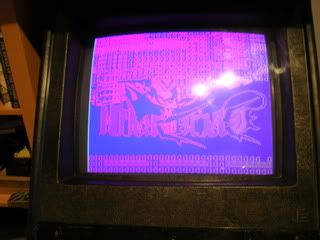

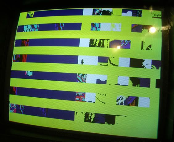

Getting on for a year ago I picked up a bootleg Black Dragon board on ebay that was sold as faulty.
Got it home, plugged it into my cab and got this screen..
Checked the voltages and ribbon cable connections and they were good. Very few marks on the board, one fair sized scratch but the track underneath was still good.

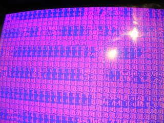

So I de soldered them, fitted sockets and installed new RAM. That gave me the different screen of crap on boot.
This crap looks like a hotchpotch of graphics elements, blocks of gfx data from the game world. Amongst that crap was often the text "Check RAM ROM". I had no idea if that was an instruction, or a the title of a test that doesn't run. Either way I took it to mean the same - the board can drive but the data is borked. Oh and sometimes after a few seconds of that screen I get a rather mashed game splash screen, at which point the system locks solid.

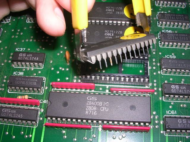

ICs 43 (RAM) and 44 to 48 (ROM) are in a tightly formed stack of sockets, a number of them had rusty contact pads within the sockets so I de soldered all the sockets and fitted new machined pin sockets in their place. Its easier to remove them sequentially than it would be to fit the RAM in a new socket and then come back to try and remove one with a socket on both sides. It also let me see the track layout under the sockets as the address line connections between them were not what I was expecting. I couldn't find the schematics anywhere so seeing where the tracks went under this section meant that I could buzz them all through.

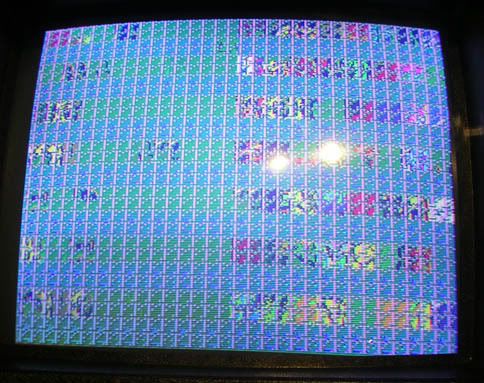

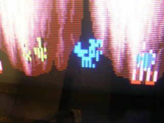

When that was complete the board then gave this.

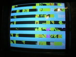

or this
As I was assuming the remaining couple of 2018s were ok on the video board based on the logic probe test there was only one other RAM chip to change -  a fat 2016 at IC86.
When I replaced that with a new chip the board burst back into life.

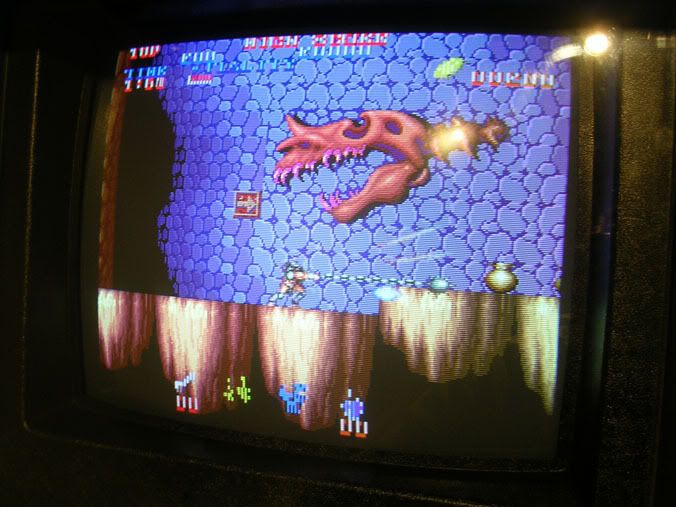

It was still not quite right as the icon graphics and text are all corrupted as you can see on the above photo and this close up.
I traced this to ROM #15 at IC112 on the video board, when this ROM is removed all the text and icons vanished from the game. The ROM read as "out of spec" in my reader, but as it was a PROM I had no idea if that meant anything or not, and I couldn't find a Black Dragon MAME romset that had the rom layout that this board has.
As Black Dragon is the Japanese version I was always planning to turn it in to Black Tiger anyway, using ROM 15 from the Black Tiger set with the original Black Dragon roms covered the screen in crap so that wasn't a winner.
Using Arcade Kings instructions I burnt new ROMs for IC 44-48, IC19 & 20 and IC27 & 28 and fitted the new rom at IC112 and the game came up perfectly as Black Tiger.

The original problem went away but the backgrounds were now being oddly drawn. Its made up of vertical stripes and these were all inverted so the right-hand side of the stripe was drawn on the the left hand side. This made the game look odd and wasn't really clear until the background had an element that was wide, like the dinosaur bones which were all broken up.
