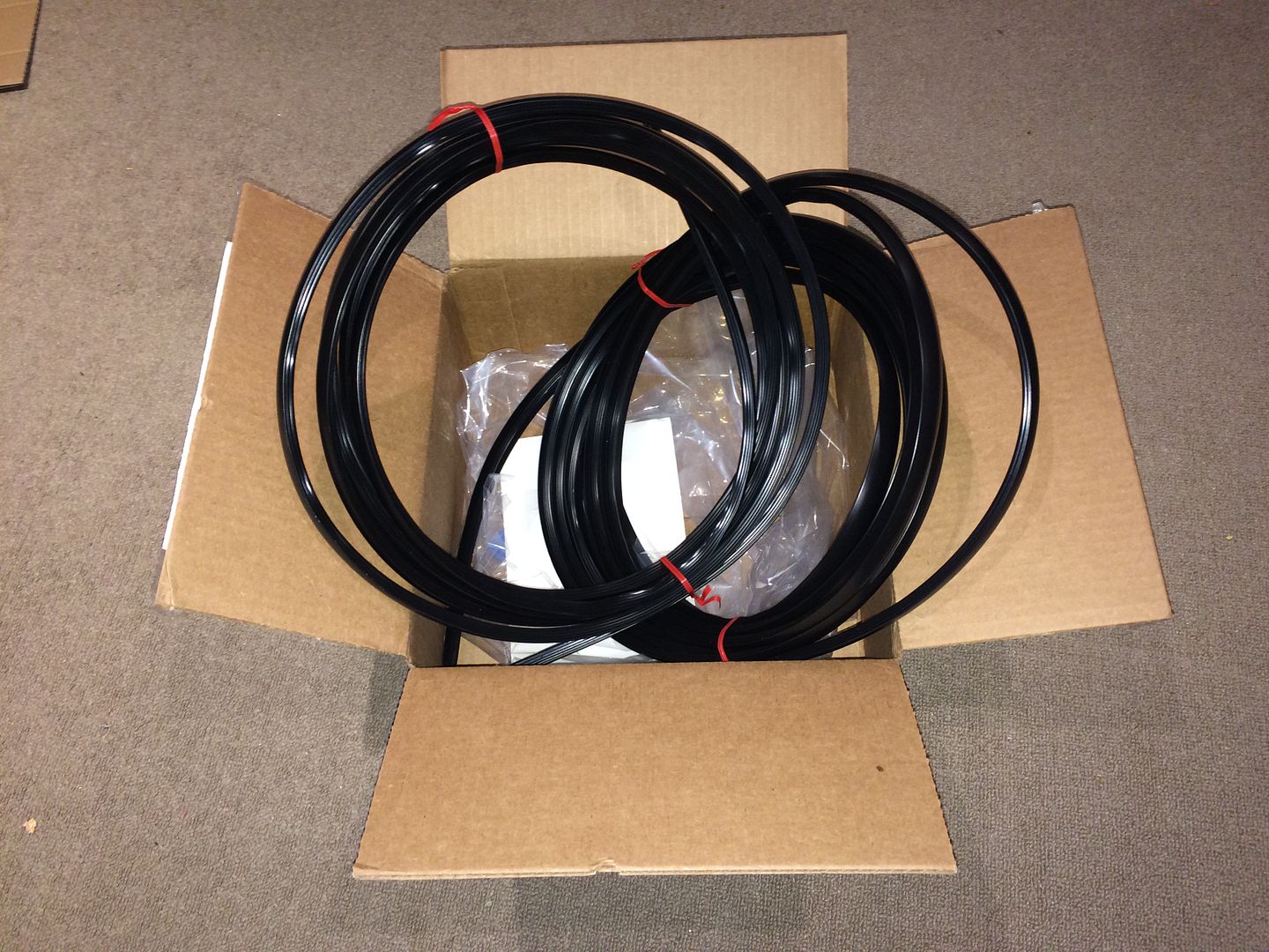

Of all the parts needed for this cabinet T-moulding has been the biggest pain, again it is the old metric vs imperial problem but there are two parts to the problem. Firstly there is the width of the actual t-moulding itself, i.e. what width of panel it will fit. This machine was born in the California, so imperial measurements are everywhere, the sheets of particle board used throughout were 1/4" thick. However down under MDF seems to only come in 16mm or 18mm sheets, and even the 18mm is harder to get. I am sure there are suppliers somewhere that stock every variation but for people with day jobs that don't involve a van the options are limited. Even Bunnings only sell one sheet that is 18mm and it is a monster, I had to get it cut down multiple times just to get it all in the car.
So when you want to get t-moulding you could look for 18mm stock, except you never know whether what you are buying is actually 18mm, or 19.06mm badly measured, or something else entirely. It gets worse in that some seller sell t-moulding for 18mm but it is actually 20mm. They may or may not clearly state this in their listings and when asked they advise that yeh it is 20mm but you just use a knife to trim it, all 30 feet of it, sounds like a great plan. Some sellers in Oz have bought their stock from US suppliers so it will be 1/4", but they may sell it as 18mm or 20mm as it is kinda half way in between. Stock from non-US countries probably are made in metric measures, probably, possibly, who the hell knows?!!!
Then you have the second problem, what size slot should you cut for it. Am surprised how many online sellers do not state that critical fact, get it wrong and you will struggled to install it, risk splitting the edge of the panel, or have it so loose you need to tape or glue it in. In my searches I have found what seem to be a number of standards, most quoted in imperial but that map roughly to 1.4mm, 2.0mm or 2.4mm.
My problem was amplified by the fact that this cabinet now contains original US 1/4" (19mm) panels in good condition, my new 18mm panels, and areas of the superstructure that were 19mm before they got wet and are now actually 20mm. Clearly one size would not fit all, but if I get multiple types to cover all areas there is the issue of what slot I need in what areas, and also whether colour/finish will match between types.
A while ago I jumped the gun and bought some t-moulding locally so I knew what slots to cut in the edge panels, trouble was I then decided that that was far to glossy for this cabinet and that I needed matte black not mirror finish black. What I really needed was matte black in two sizes that looked identical, which meant from the same vendor so I could ask about the colour match, and also from a vendor who clearly stated the exact dimensions of the slots required for each. This really narrowed my choice of vendor down to being only t-molding.com in US, who were excellent in answering my crazy questions and also selling non-standard lengths on request. I had hoped to avoid overseas shipping costs but T-moulding is light and the whole lot was about $55 delivered.
In the end I decided to go for 1/4" inch for the front panel edges, the track side panels and the original rear edge of the CP which was an undamaged 1/4" panel. I will have 0.5mm over hang on the raw panels either side, but after priming and the finishing this is probably not a problem. The other size is 13/16, which is 20.6mm in new money and a decent fit for both the worn existing slots and the areas I need to cover, especially the front inner "toe" sections of the tracks. This was the area where colour matching was going to be the problem as the outer face of the tracks are my 18mm panels and the inner faces are the original, swollen, glued and clamped up panels which are now 20mm.
Buying from one vendor almost solved my problems, except the 1/4" stock for my 18mm panels from them needed 1/16" (1.6mm) slots, and all my panels had beautiful 3/32 (2.4mm) slots. Both sizes had perfect colour and profile matched, in fact its hard to tell them apart by eye, but my slots were far too big, the groove only lightly gripped the t-moulding and it would just ping out around the corners.

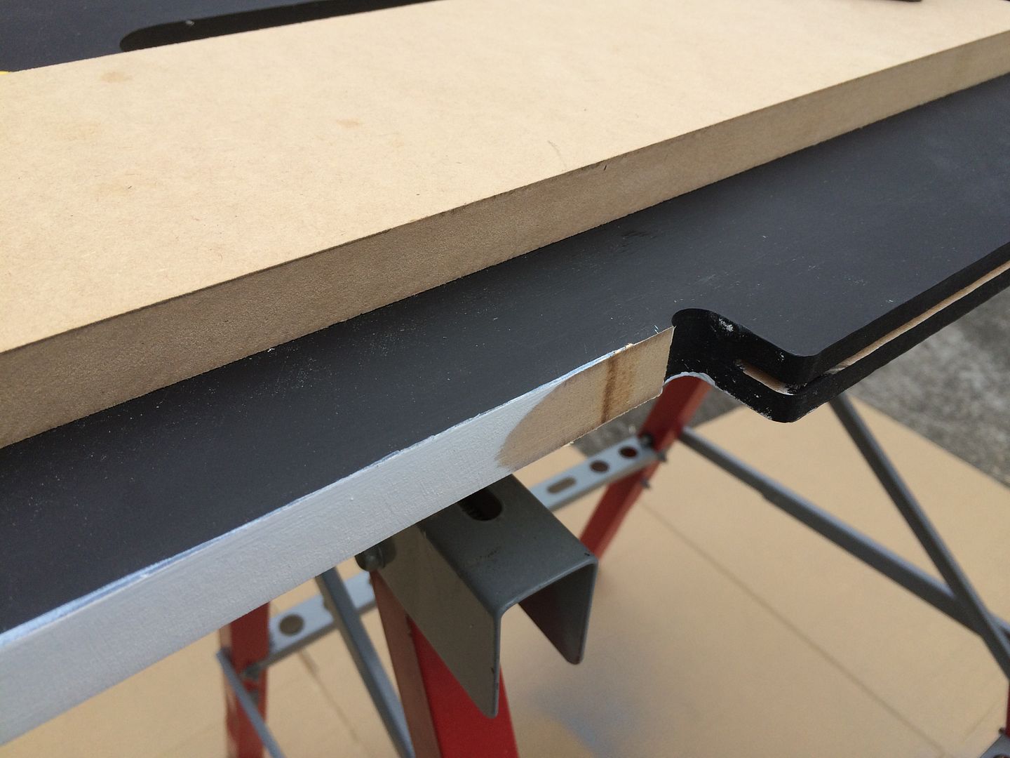

I had no interest in chucking these panels away and making new ones , even if I could be bothered I was left with the problem of alignment, these ones had the dowels glued in place to ensure the panels get installed in exactly the right spot. Those holes were now drilled and filled, so doing that all again wasn't an option.
Opinions online about this problem are varied, some people say just bondo the slots and cut new ones, this sounded reasonable except for the fact that bondo is not fun to work with and trying to shoe horn it into the grooves before it set was going to be an epic battle over the 6.6 meters of slot I needed to fill. I also didn't want to have to sand the edges on these panels as they were already perfectly straight. Any changes there would impact the alignment and if I broke that I might as well start again anyway. Also, one commenter on Klov said that bondo isn't ideal as the new grooves have edges like polished glass, and the t-moulding doesn't grip very well. Having met routed bondo on the training edges of the cabinet this sounded very plausible and a good enough reason to ditch that idea. Another option was to cut strips of cardboard, bent into V shape which you hammer into the groove along with the t-moulding. This probably would work, especially if the cardboard was covered in glue on the wood side. This just sounded a bit too bodgy for me and I can imagine it is hard to get the thickness right, and getting it all to go in straight is probably not as easy as it sounds, corners would be a nightmare. The other suggestion is to glue it in, with hot glue. This would take hours, plus I would have to find someway to hold it all in place perfectly while the glue set, plus any glue oozing out would make a mess and you only get one shot at this, try to remove a section and you would wreck the slot, the t-moulding and possibly the panel.

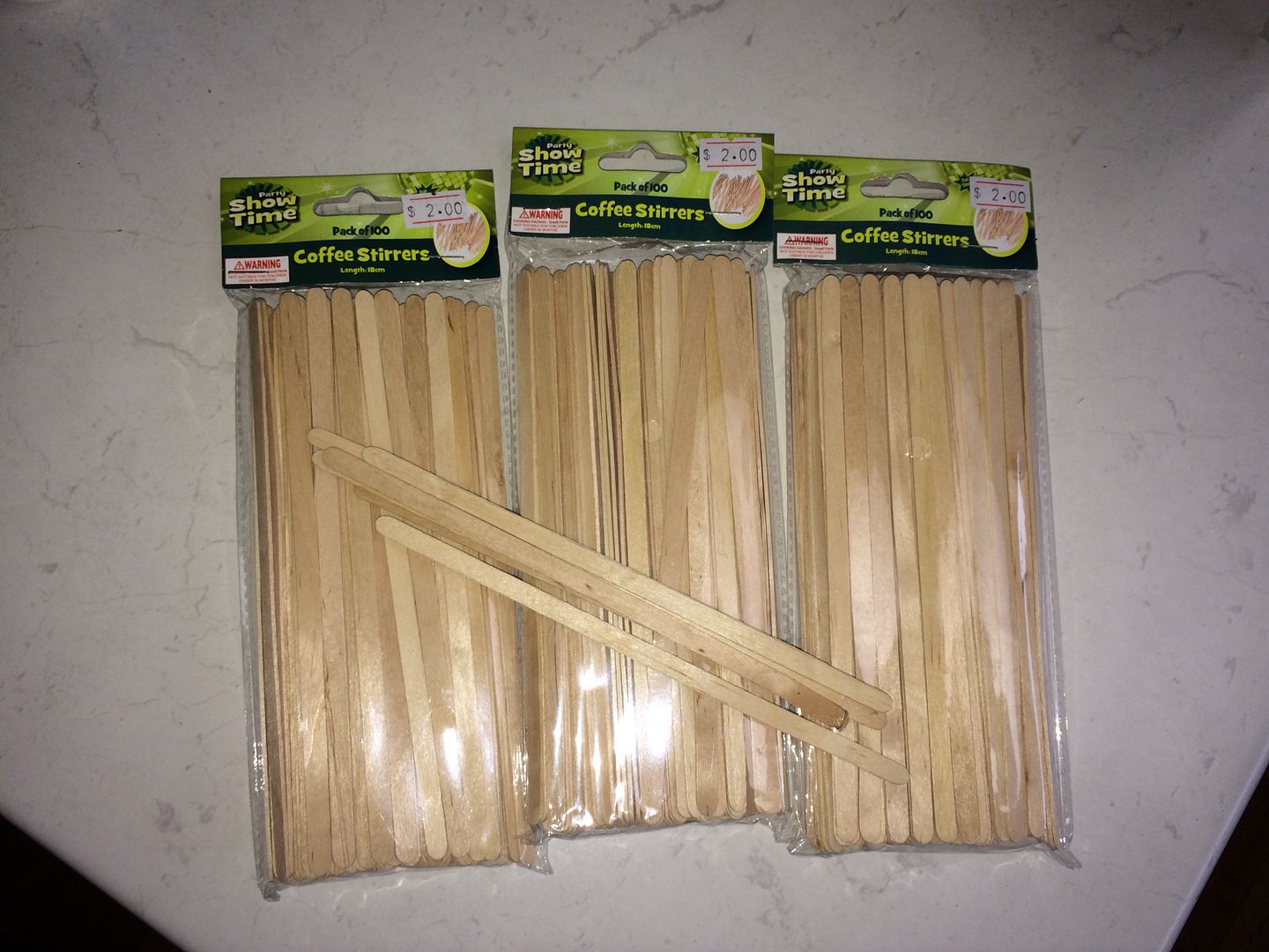

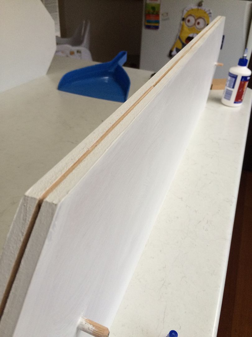

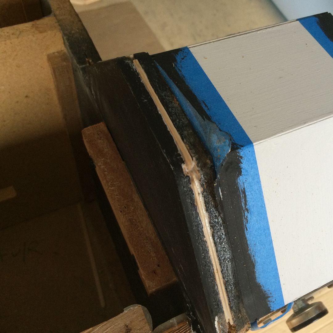

I needed a better solution, ideally what I needed to put back in the slots was actual wood, something I could route normally and have a nice rough surface for the t-moulding to grip, but where do you get long thin strips of wood for such a task? The answer is probably every supermarket and $2 shop in the country, introducing - Coffee Stirrers :)

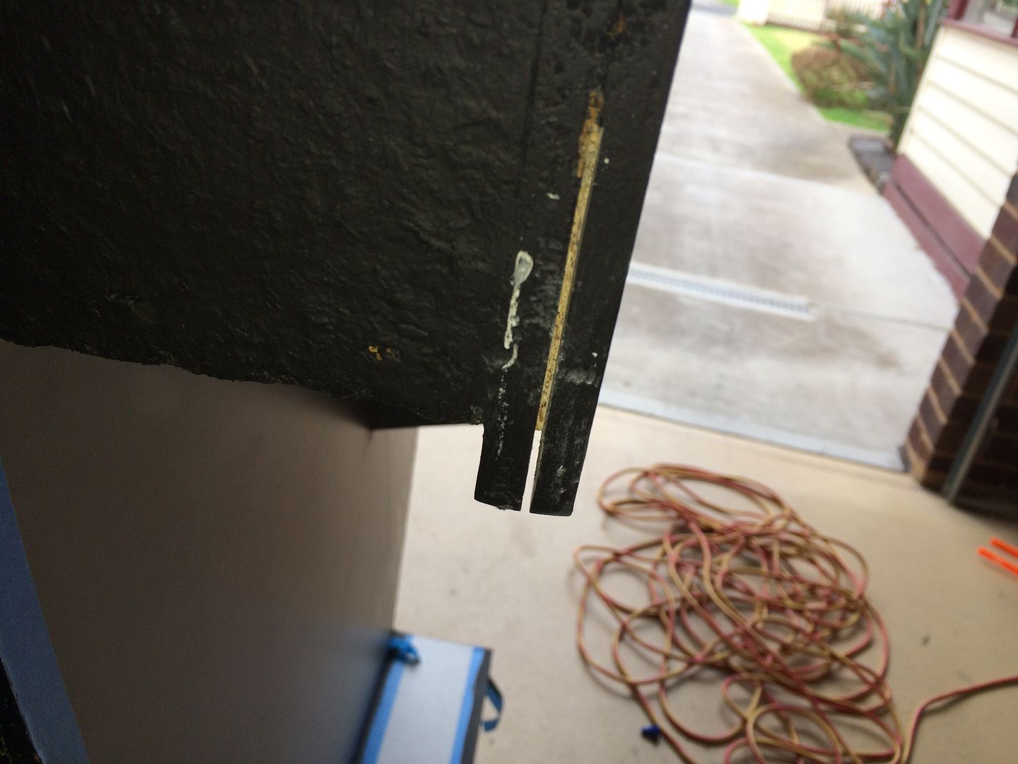

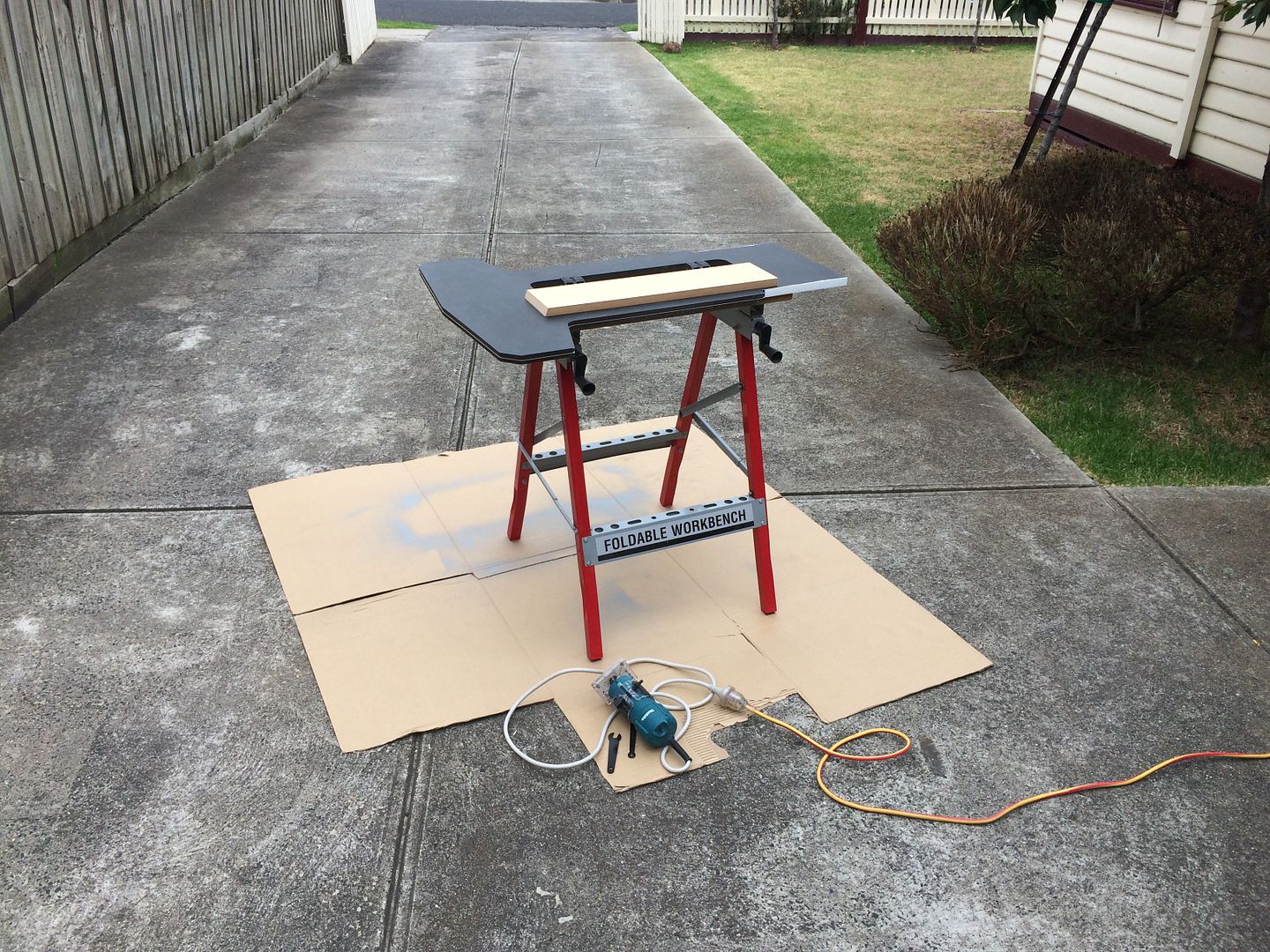

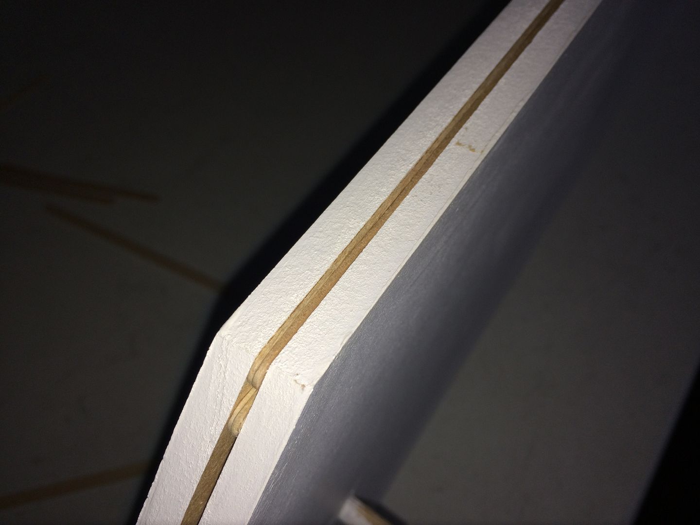

By some fluke of good fortune, two coffee stirrers back to back are the perfect width for the slots I cut and two pairs side by side were the perfect width to fill the depth of slot to the original surface. Plus at $2 per pack it's by far the cheapest of all the options I discounted anyway. Of course with this project things are never quite that simple, because I had primed the edges, the primer filled the slot ever so slightly and now the coffee stirrers wouldn't fit any part that was painted. Scraping the primer helped a bit but the simplest option was to re-route the wrong sized slots with the bit I originally cut them with to restore their fully width.

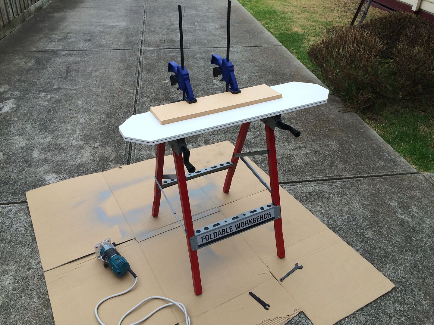

Getting the bit alignment is the hardest part of using a router, but once set I buzzed along the grooves creating a fine mist of dust and not much else, but the slots were now ready for filling.
While the front panel was clamped to the workmate I also took the edge cutter bit to the lower section of the control panel, it was too tight at fit against the inner track edges. If the fit was tight now it would be impossible when there is vinyl on the track inner edge. I had sanded these sections down and re-primed them but I wasn't happy with the straightness of the edge. A piece of wood clamped as a guide let me trim it completely straight again, I think I was only 1mm out but it looked wonky before.
Coffee stirrer and PVA glue time, this is one of those jobs that you think will be quite quick, and on the straight sections it is, trouble is the angles and fiddly bits slow you to a crawl.

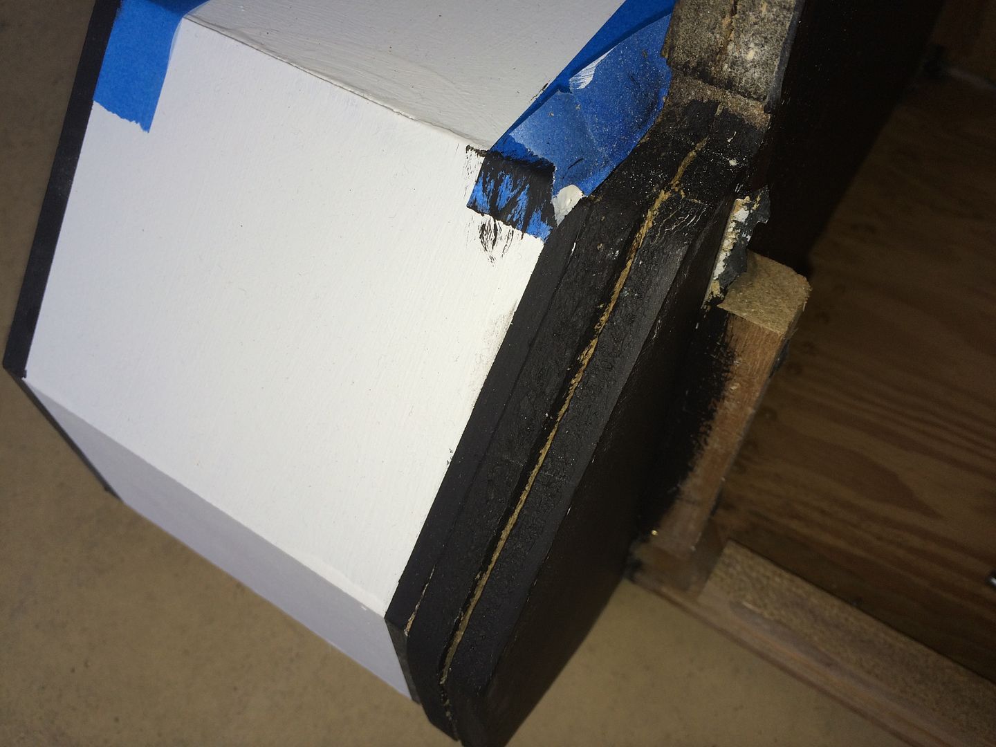

Front panel!

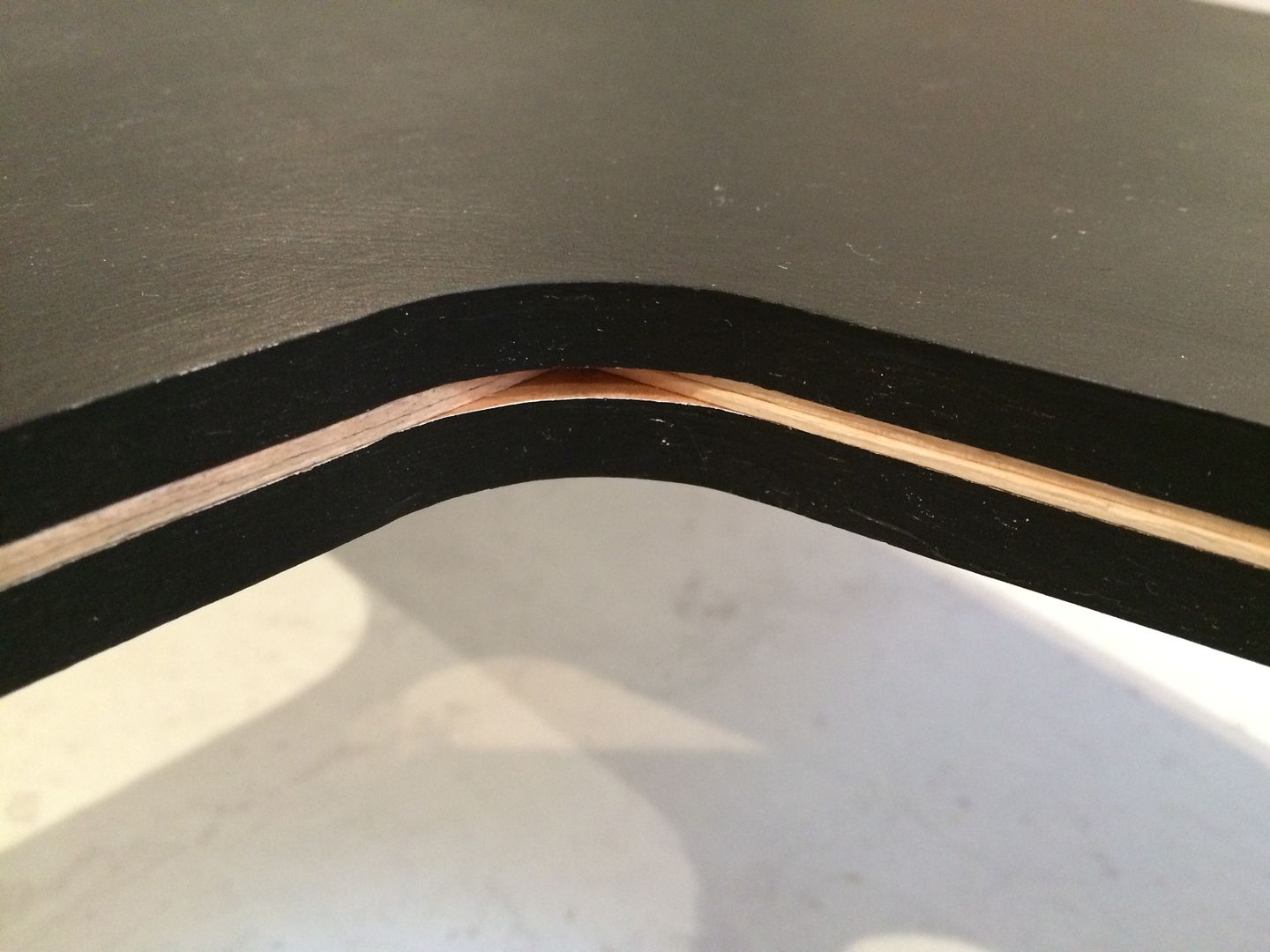

Corners are less of a problem as the spline gets cut away there to let the t-moulding bend to take the turn, so there is nothing needing anything to grip in those areas anyway.
All in all it took me about two and half hours to fill up the track edges and the front panel but the result is a very neat job. Some areas had small gaps that needed filling but I could cope with that small amount of bondo work. These needed a good few days drying time as lot of glue was used, so I got on with some other routing job.

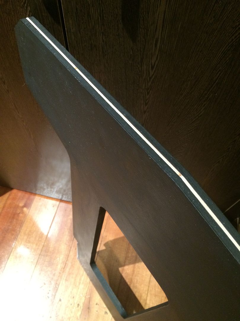

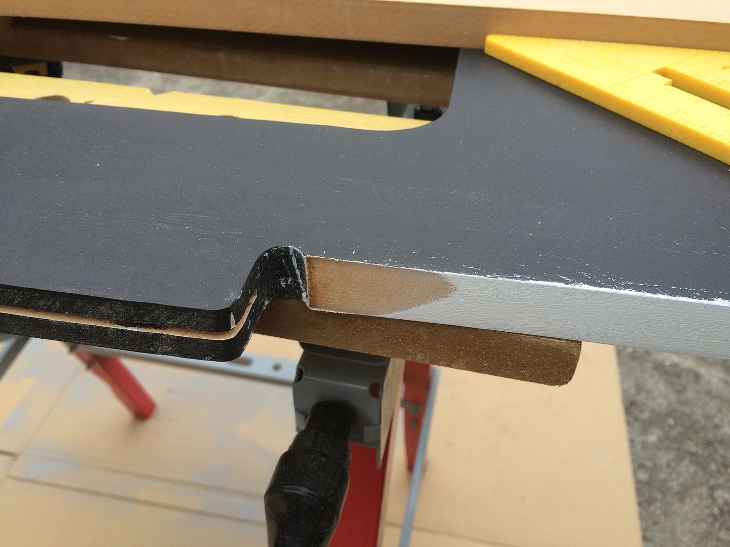

I decided to do the coffee stirrer trick to the front inner track areas, these were originally badly water damaged and I was not totally convinced they would hold the t-moulding in place. After a rip through with the router it was clear that they will be a lot better after the coffee stirrer treatment than before.
While the router was out and set up I quickly re-cut the slot on the rear corner of the monitor shroud as that had been completely filled when that area was rebuilt.
Straight as an arrow!

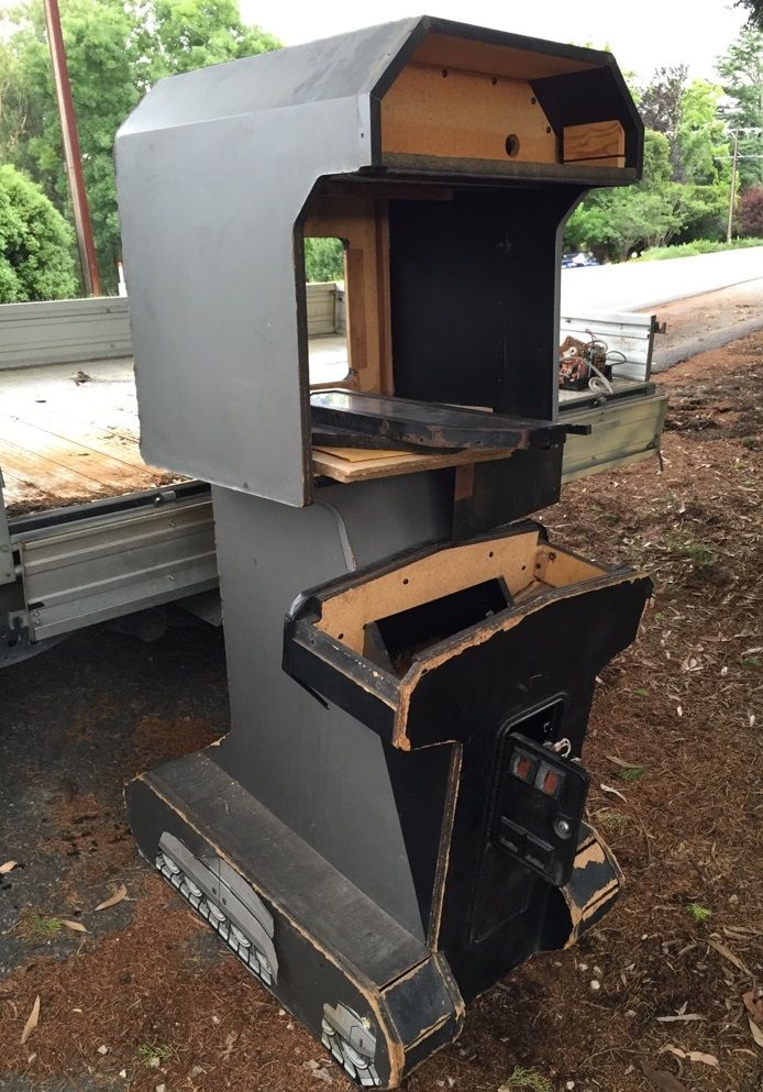

A bit of a side story now!

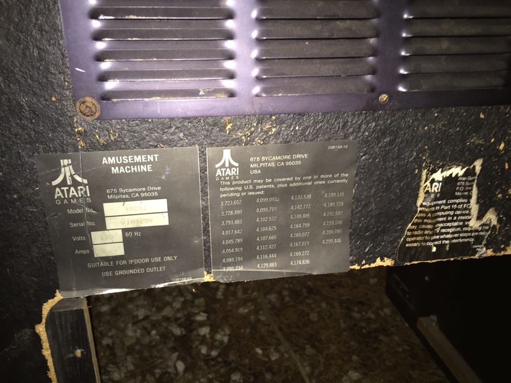

A few weeks ago a thread popped up on AA with the title "Free Vindicators Cabinet", and I admit my heart sunk, I had visions of a perfect cabinet, complete with artwork, probably missing some of the electronics but available for free, and probably just down the road from me.
Actually it was in SA and it was a gutted shell, in far worse condition than my one had ever been.
I know how bad things can be on these cabs and still look mostly OK, but this one looked dreadful so was probably even worse, but between AA members Camaro and Phreak97 I was able to get some useful parts and some missing info that will help mine live again. Many thanks guys!!
Amazingly it was Serial number VIN1229, mine is VIN1222!!!
It is very likely that they rolled off the Sunnyvale production line on the very same day back in 1988. Sadly it was basically just the wooden shell, all the electronics, PSU, control panel and wiring was gone, in fact some of the doco suggests it was converted to a Pit Fighter, which was released in 1990, so this was probably only a vindicators for a couple of years.

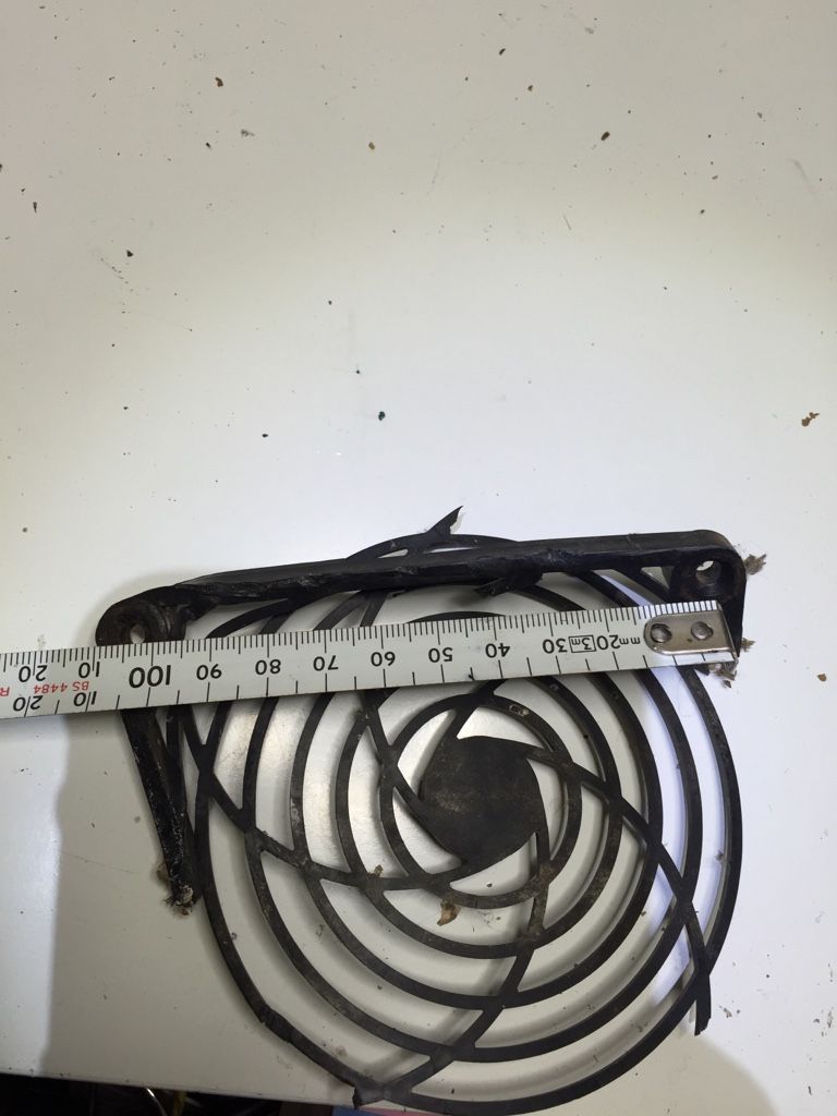

It sticks out too far so it gets knocked and bashed about, and crushed if the cabinet is ever laid on its back. Knowing what it should look like I was able to find a very good replacement with a bit of Google image hunting.
It fits the bill of being as close to the original style as I could get plus it has a similar looking cover and a foam filter to keep the spiders from moving back in.
It needs to be installed once I am past the point of laying the cabinet down, which means after the front panel is fitted, but now is the time to pre-drill the pilot holes for the screws while I can still get comfortable access to the area.
It looks huge but the screw holes line up with the originals so it is spot on.

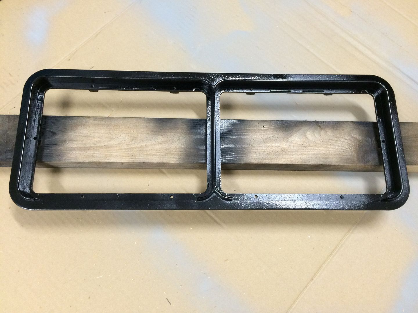

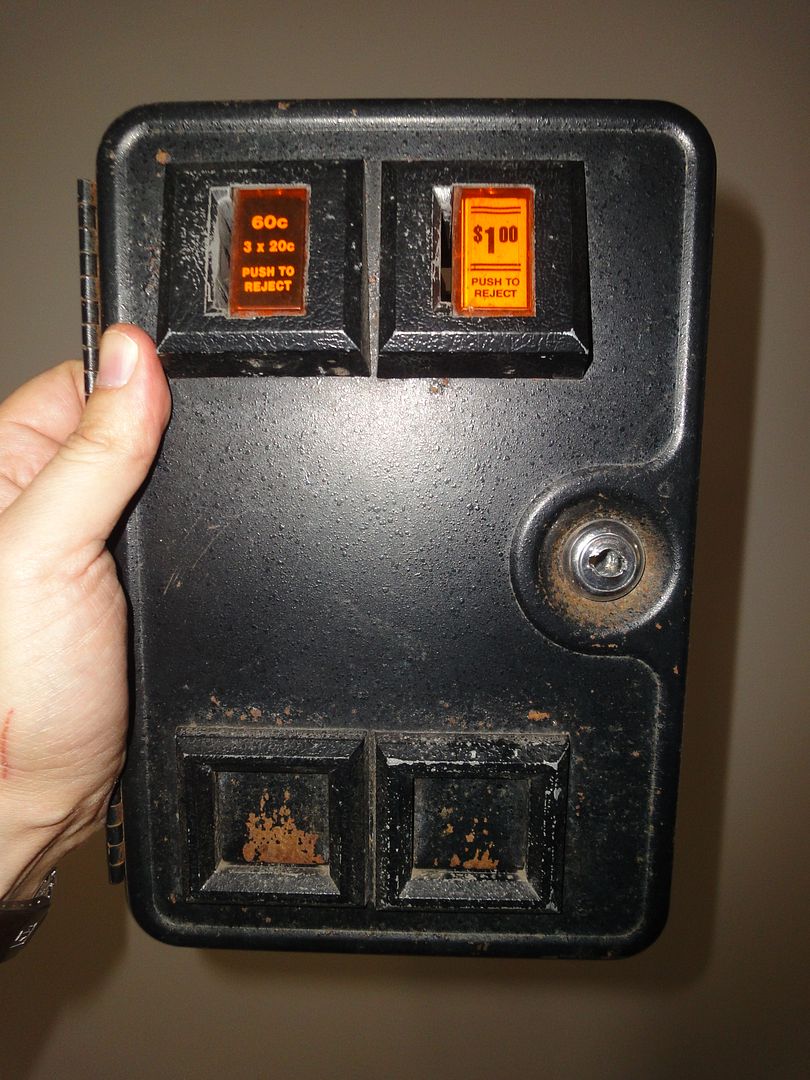

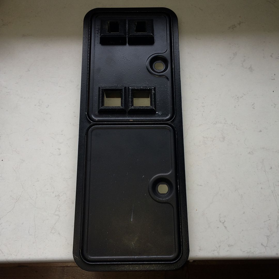

When the cabinet arrived, the coin door looked like this, even worse...
The really rusty coin return flaps were quickly sanded back to metal, cleaned and then hit with primer.
The other parts were just hit with the spray can.

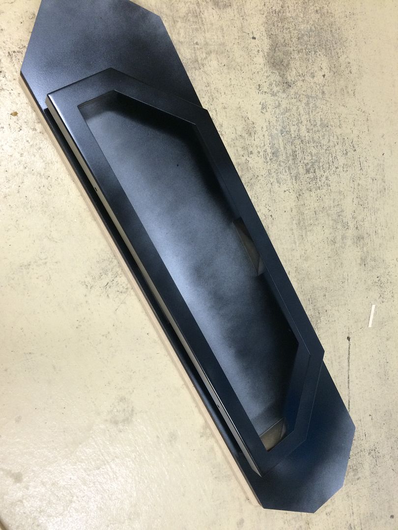

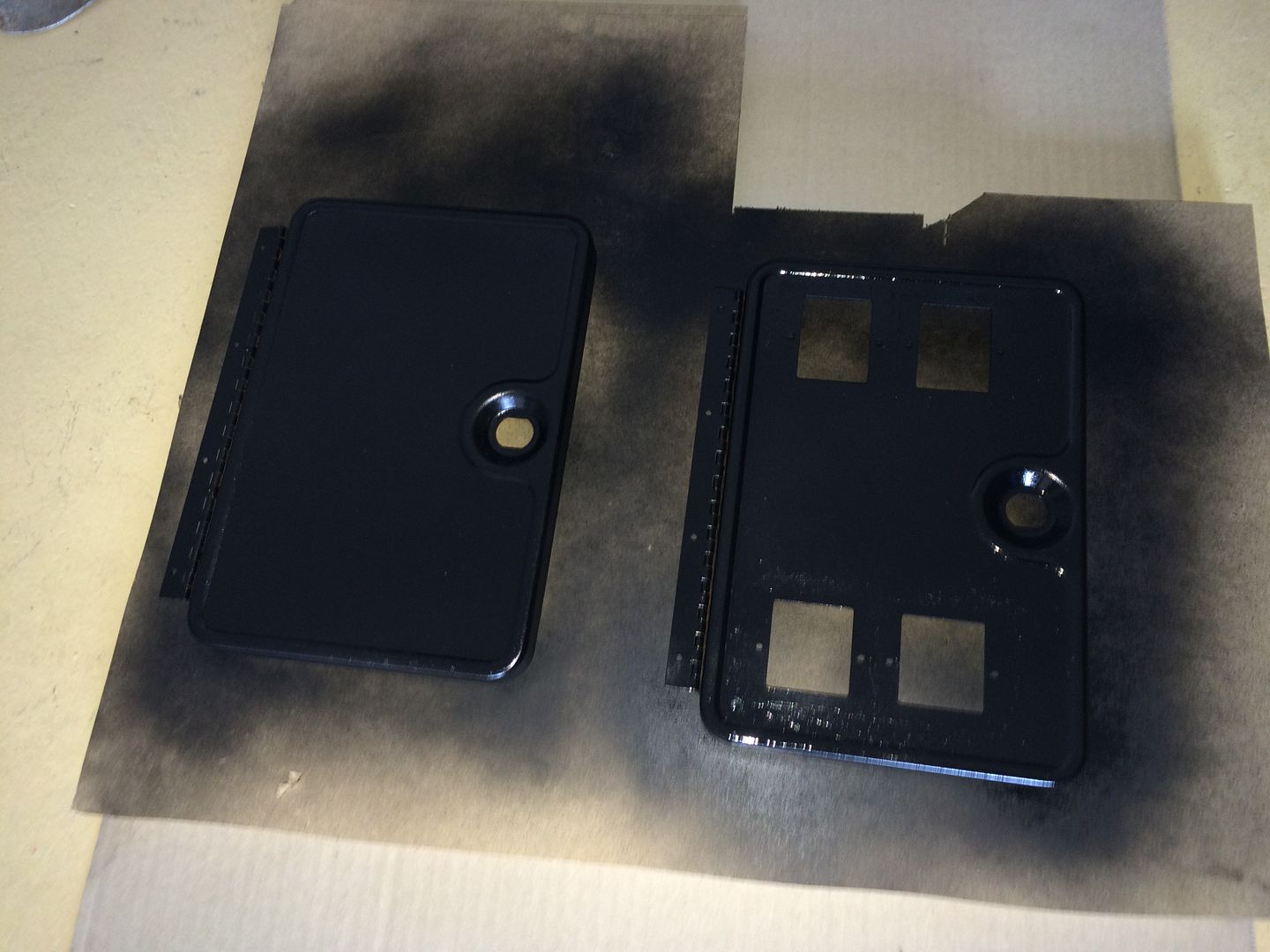

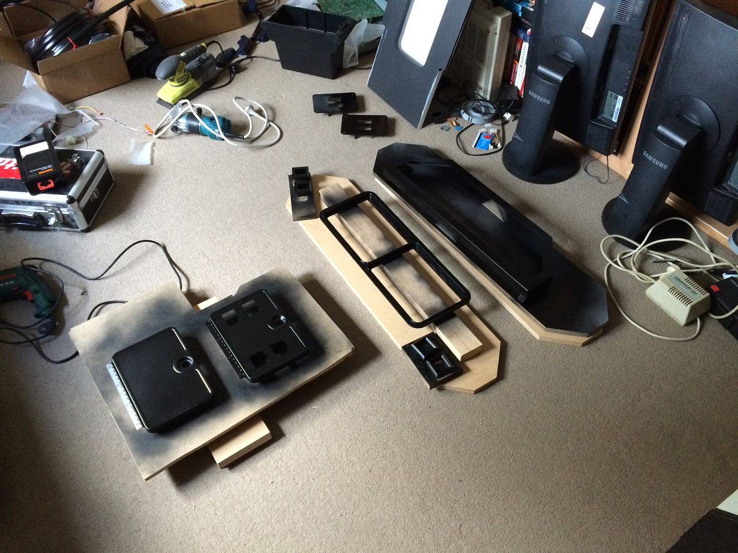

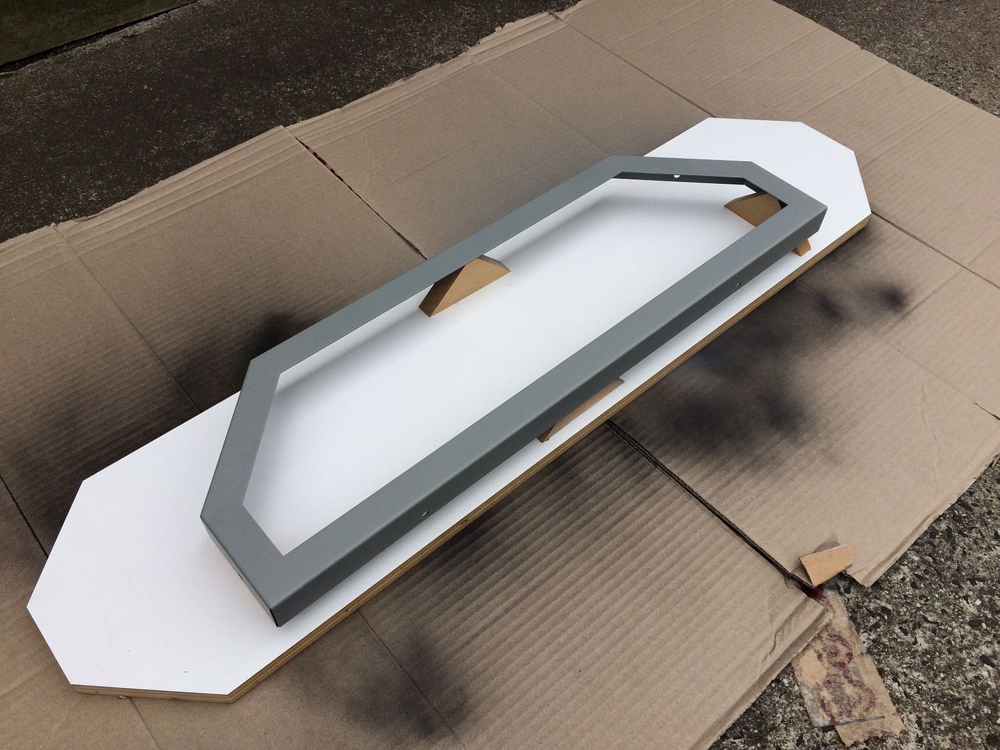

The monitor bezel had taken a couple of coats of primer to get an even finish in the previous week.
So it was propped up on the triangle off-cuts of the track panels, on one of the scrap ones for easy of transport, and given a light coat of black.
The rear power switch plate which was on its second painting attempt after a gust of wind caught the cardboard it was sat on last time, throwing the whole lot down the drive onto the concrete completely wrecking the pain job. That had to be sanded back to bare metal a second time due to all the chips and grit on it.
I hate spray painting, if you want to invoke wind and rain the best way seems to be to shake a spray can, suddenly the wind just appears. To avoid over-spray this was done down the far end of the driveway, and the parts were carried inside on individual planks of wood immediately after painting to fill the toy room with fumes, but to dry out of the wind and dust.

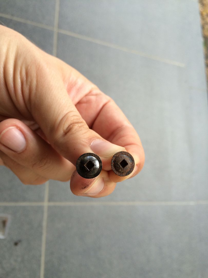

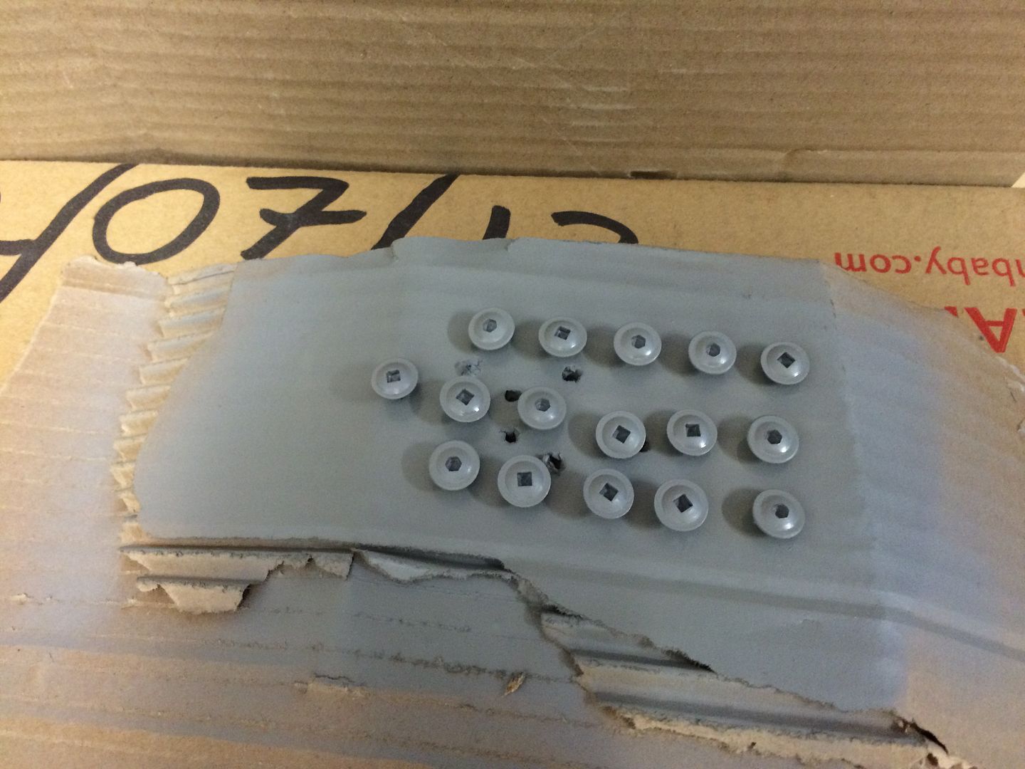

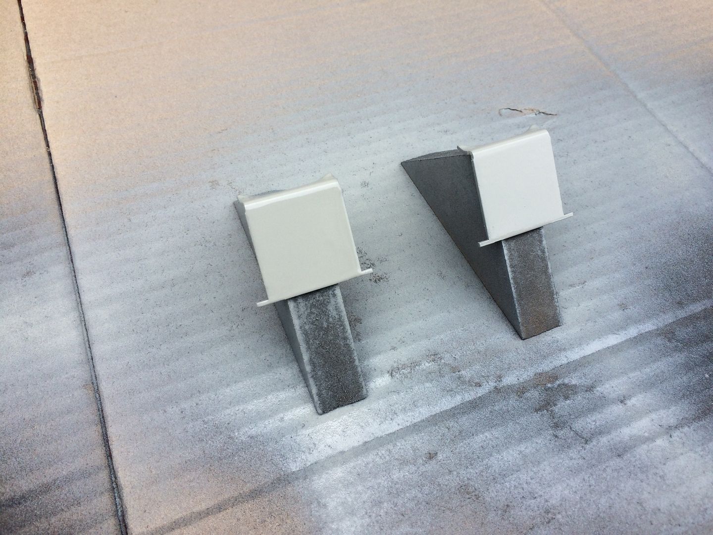

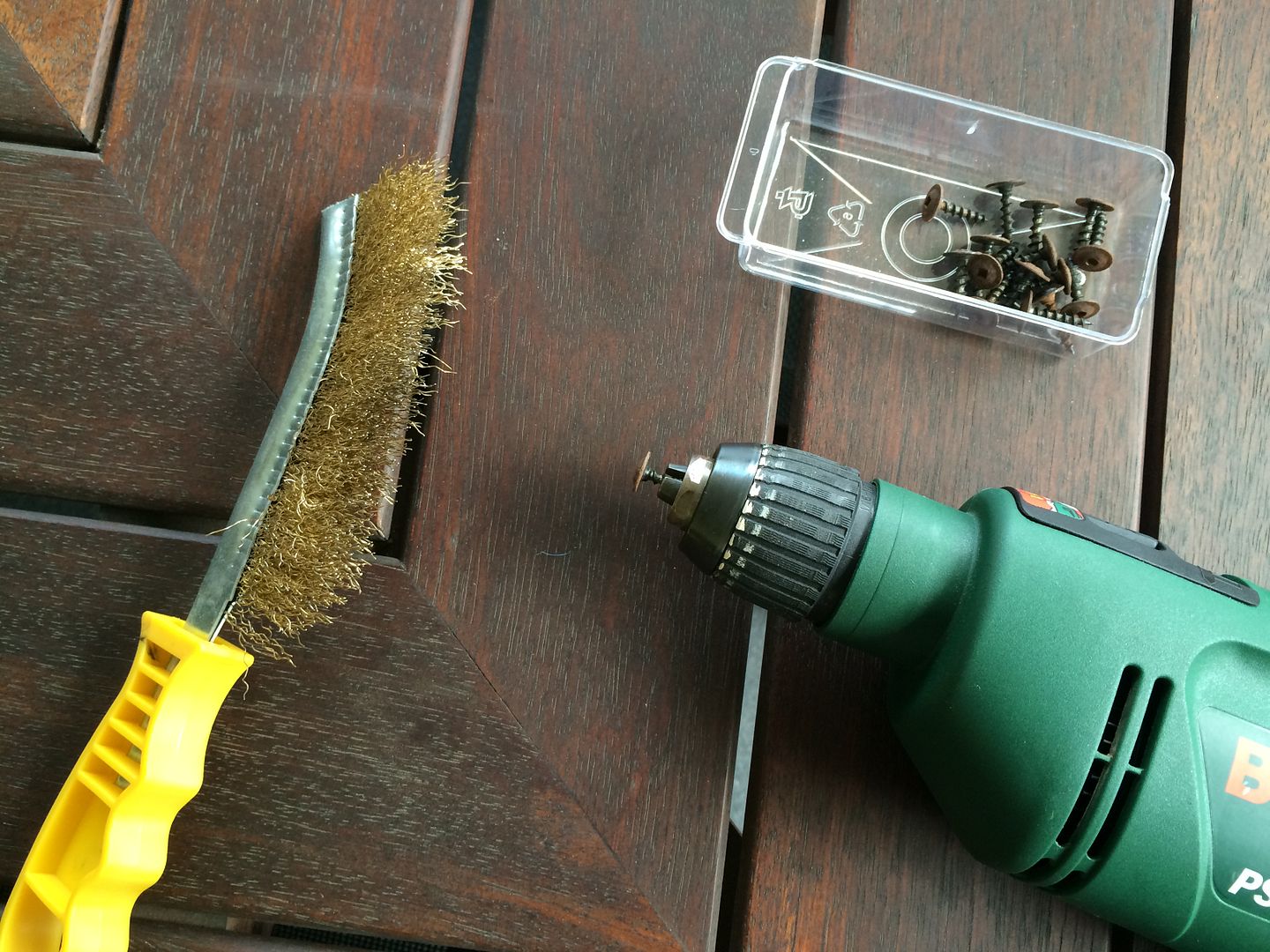

The only other parts needing attention were the collection of rusty screws that were destined to go back on the cabinet. A wire brush and a couple of hundred rpm in a drill soon sorts that out.
Before and after!
One the set was complete, the whole lot were primed...
...and half painted, I knew the spray can was nearly empty but it gave a final cough and died, about 4 seconds too early.
Another can needed to finish the job, and in fact everything got another coat anyway as the coverage on a couple of areas wasn't as good as I had hoped and also to ensure a colour match.

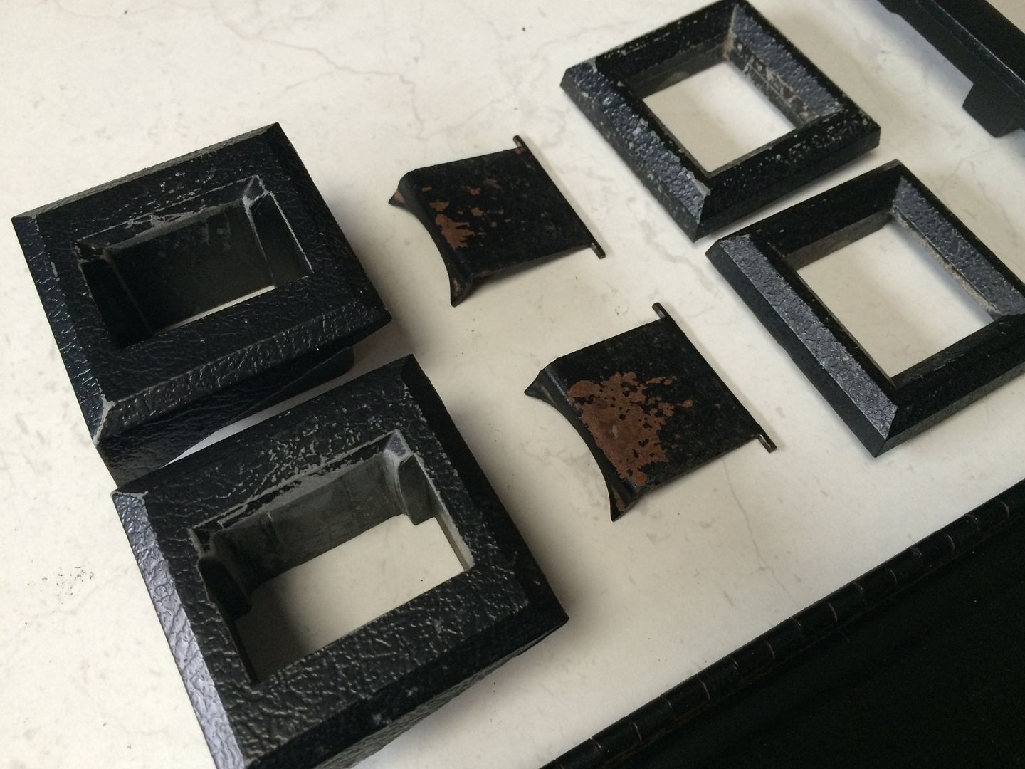

Next big item on this list - controllers! Except the blanking plates still needed something doing to them. They had been badly spray painted along with the rest of the controllers at some point in the machines history. So they had splodges of black paint where they were exposed by the controller plates. I had got a lot of the spray paint off with a fingernail and hot water but I was still left with this.

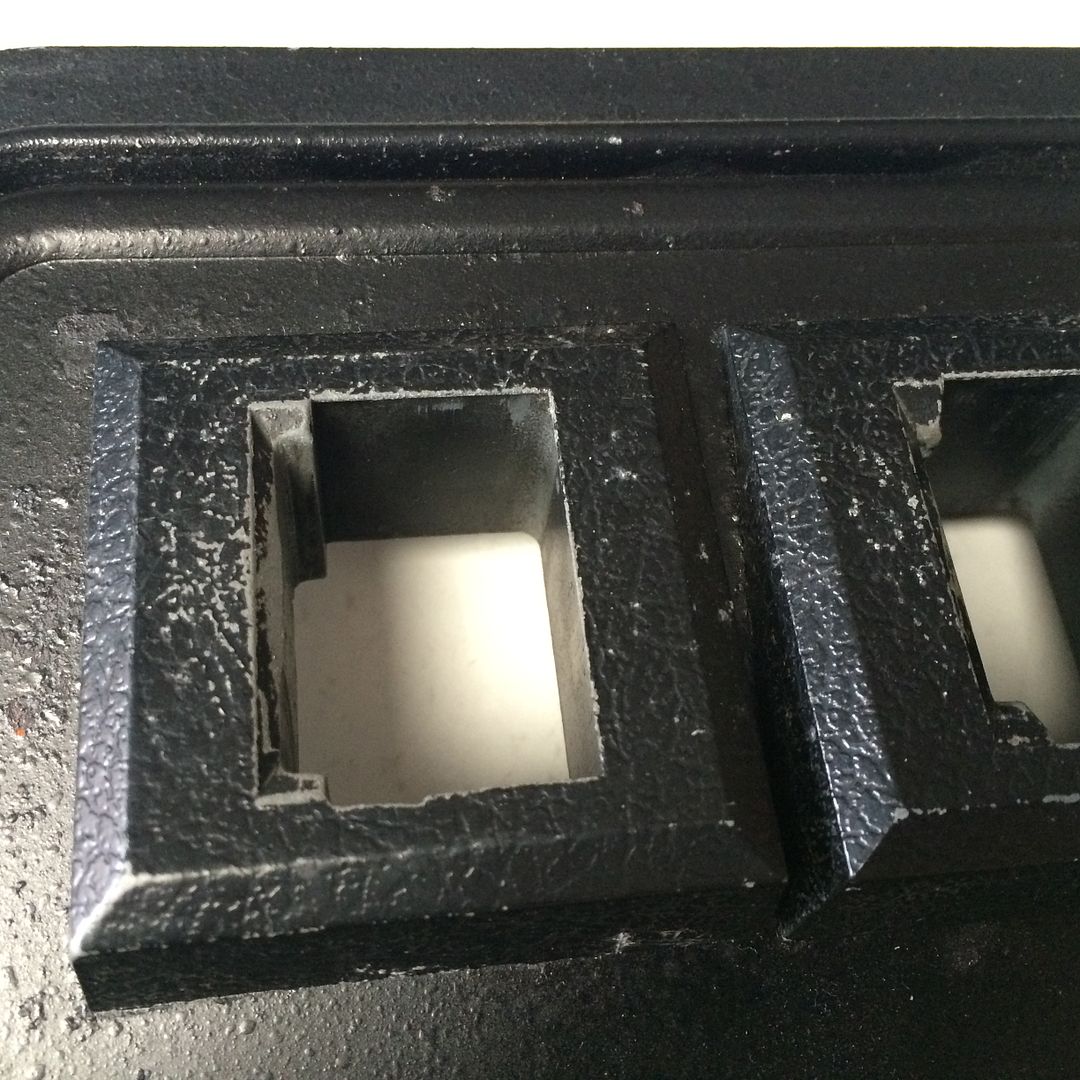

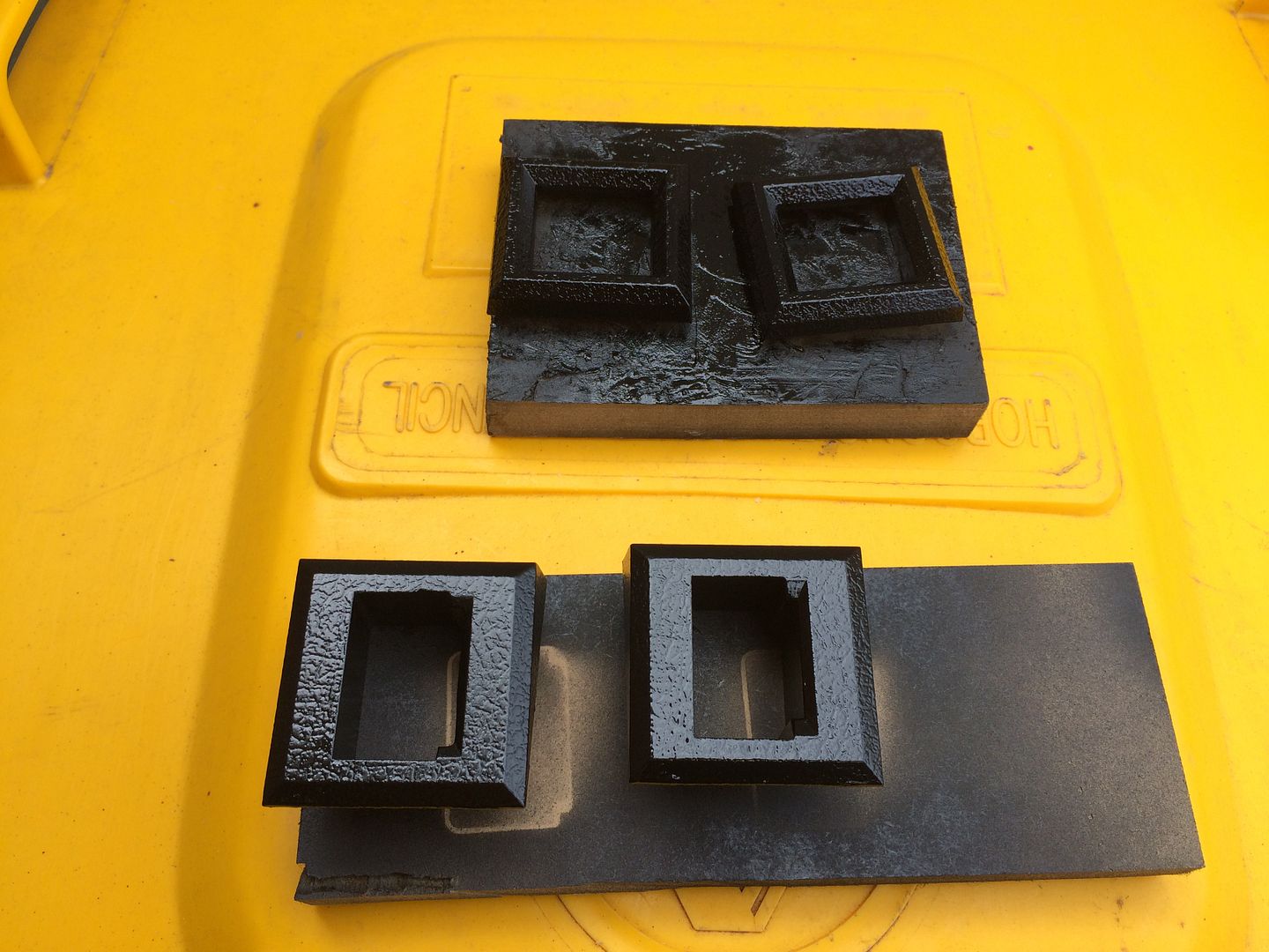

I had considered painting them with matte black spray paint, but as these things slide back and forth the paint may start to show signs of wear, plus I didn't want to in-fill the texture with yet more paint.
The solution - Simple Green, it seems to feature in most arcade restoration threads from the US and surprisingly enough, seeing as it is just a cleaning spray, Bunnings sell the exact, made in the USA, stuff.
Despite being a decent cleaner it also will eat paint if you give it enough time, apparently model makers regularly use it to soak old paint jobs off plastic models. There are a lot of threads about people trying alternatives, but for efficacy and the fact it doesn't seem to damage the plastic underneath Simple Green seems to be the top rated option.
All up it took 48 hours in the stuff neat to get all the paint to lift off, minor encouragement required an old toothbrush and a needle mounted in a pen drill to pick the last bits out of the texture.
Then I had to do it all again as for some reason I forgot that two controllers = 4 plates and had only done two, but it takes no effort beyond setting it up and leaving it alone.
After, and before.

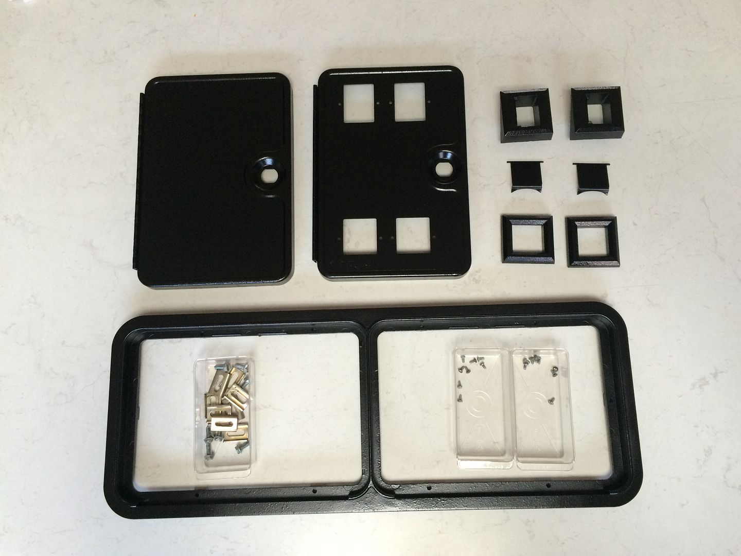

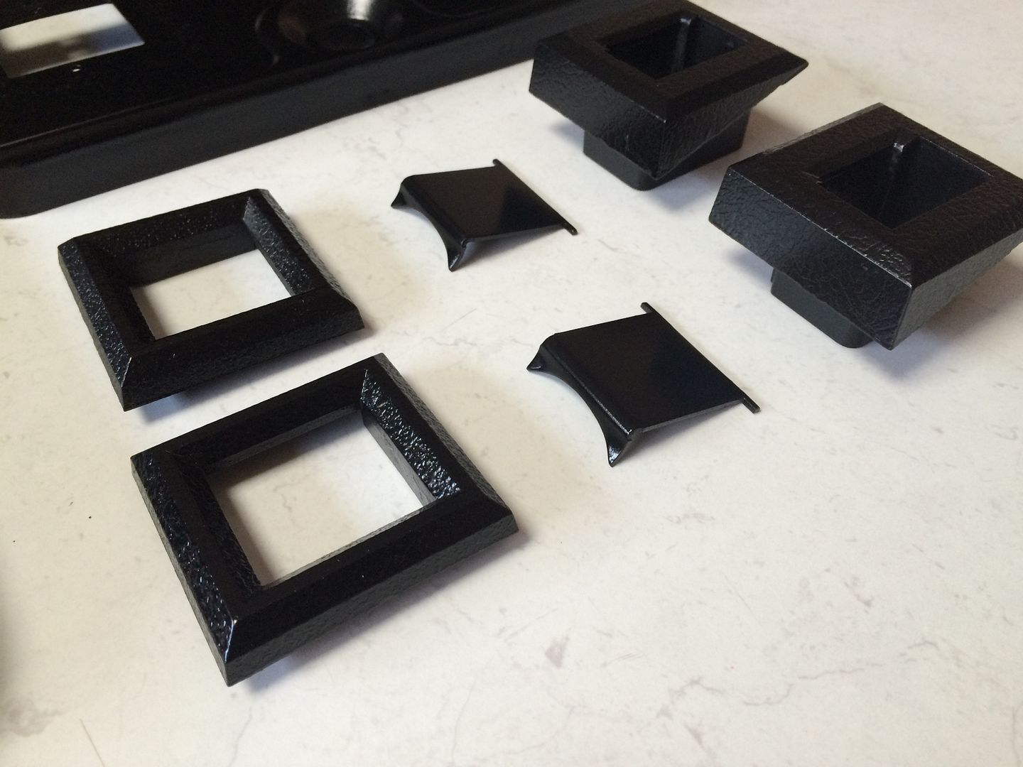

With the controller blanking plates free of paint, extremely clean and now dry, I could get on with the controllers.
The powdercoaters had fixed their cock-up, striped and re-coated the top plates without clogging the threads, so it was just a case of picking off the masking tape...
...and starting to build...
...face down on a towel to protect the finish...
... and test fit the blanking plates, looking great!
Now to the tricky bit, and the first problem, powdercoating adds thickness, probably more than paint would, and the controller hand grips would not fit over the tubes. They would slide on up to the bend and then jam solid.
Just what I wanted, an opportunity to scratch the crap out of the powdercoat finish. My allegiance to the expensive powdercoat was greater than to 0.5 mm of scuffed blue plastic on the handle grips. So the holes were given a light sand with very fine sandpaper to smooth them and also to make the hole slightly bigger. Sand paper wrapped around a finger seemed to be the way to go here.
With the grip now engaged on the inner plate I screwed the two halves together to stop it flapping around loose and scratching up the tube, onwards!
Armed with photos from the disassembly, the original manual that vaguely describes the process, and a tray of parts...
...the rubber bump stops go back in, and the first test install of a controller arm plus blanking plate revealed the second problem. The arm was too tight in the main cage, thankfully this was more due to the alignment of the parts and not the powdercoat thickness.
So I removed the arm, and loosened the nuts holding the top plate assembly together and it freed up.

A combination of Easter and life in a plaster cast derailed me for another fortnight, but with some strength back in the elbow I could at last get on with the cabinet again. Track time!
To ensure a good join between the two pieces of matting needed to cover the length both were clamped in place at the ends and masking tape applied so I could glue them in stages.
The glue required that both surfaces be coated, and left separate for 20 minutes, then brought together, at which point the glue grabs instantly. Not ideal, but the plan was to roll the pieces together, hence the need for clamping in place at the ends.
With the track peeled back and supported on a plank it was time to get the glue going.
It is horrible stuff, it only seems really keen to stick to itself, and has a tendency to peel of the surface entirely and wind itself up into a ball.
I ended up picking the snot like bundles of glue off the woodwork...
... and trying again. I did not have high hopes that this was actually going to work, but after 20 minutes the glue did seem ready to do what it was supposed to, so with some careful rolling out and some rapid clamping I got the top surface down.
Time for the rear ends, purposefully did the rear first, in the hope that by the time I did the fronts, which will be very visible, I would be better at it and have worked out what not to do.
Damn this glue is horrible to work with.
Looks like far too much, but it worked.
With the mat down and hammered flat with a block of wood I moved to quickly installing the wheels again. I had marked on the edge the lines on which the screw holes were, and they were a neat 5cm and 7.5cm in from the edge. So after a quick go with a finger drill at the right points, followed by a bigger bit in the power drill...
...I was able to fit the wheels for the final time.
Same deal on the other side...
The trick seems to be to pour the glue on, then work very fast to spread it out before it starts to bundle up. After 20 minutes it grabbed on and the top part was done.
End piece down...
... and wheels back on.
Not a bad looking rear!!
The front sections had to wait a day, to be sure the back sections were fully bonded before they had the full weight of the cabinet laying on them while the front sections were glued. I needn't have worried, if I prop the back up on a foot stool and a blanket the rear rests solely on the wheels, which makes it easier to work on the tracks anyway. Same deal as before, makeshift platform to roll the track back onto while the glue gets ready...
... frantic glue smearing before it turned to snot.
Then twenty minutes later the surfaces are pressed together and the glue slams shut.
Two milestones got knocked over today as Radirgyman popped round to help out with applying the vinyl to the front panel, another job I wasn't looking forward to. On his advice I had picked up a length of PVC pipe to roll the backing off onto, and a plastic scraper, armed with those it went on pretty easily.
The end result looks stunning...
the areas where it is wrapped around the 90 degree bend seem less keen to stay stuck, especially around the coin door cut out as I don't recal taking too much care with the inner surface, but as the coin door itself clamps in hard around those edges the best option to keep the vinyl behaving was to fit it.
The outer edges are less of a problem, but they will need a trim anyway to reveal the t-mould slots, to avoid any vinyl escape attempts I am leaving the trimming until I am going to fit the t-mould, other wise it has more time to misbehave. I expect the t-moulding will keep everything nicely clamped on the edges so am not concerned.
Time for another dry fit!
The front face will remain clamped for at least 24 hours minimum, if there is any section of rubber that needs to be well bonded it is that portion.
I predict t-moulding installation is on the cards for this week. I also need to trim some of the installed rubber tracking with a razor blade as for some reason its a couple of millimeters proud of the edge at the back along about 10cm, but then the side panels will get t-mould and will be finally glued in place. As will the front panel, and then it is time to reinstall all the good stuff as the cabinet exterior will be 99% complete, just a few tweaks here and there.

Onwards - time for T-moulding, thankfully this was not the shit fight I was expecting it to be. After the issues with me cutting the wrong width slot, and then fixing that with coffee stirrers, plus the copious amount of bondo work, and old sections of slot that I couldn't get a router bit near to re-cut, I was expecting this to be a bit of a battle.
Starting off midway along the underside of the track panel...
...with nick cut out of the tongue to let it bend neatly around the corners...
... and it all went on very easily.
I ended up using a soft cloth between the rubber hammer and the T-moulding as it did leave slight marks on the first bit, thankfully those are on the underside so completely hidden.
First lap completed...
...with a sharp knife to get a neat joint.
Just one to go to get the matching pair.
When trying the sides on for size I discovered that I had cut the rubber matting slightly wonky at the rear of the left track, it was overhanging the wood by a few mm which meant the side panel would not fit properly. I cut a notch in a piece of scrap MDF to act as a guide to allow me to line up a steel ruler with the wooden edge under the overhang to use as a cutting edge, and ran a razor knife along it.
Time to seal up the tomb, it got a final clean up and vacuum...
... followed by one last dry fit...
...which showed that it had a slight bow outwards in the middle which would need persuasion to behave. I also took some sandpaper to the areas where I wanted a good bond to remove the primer back to the bare MDF to let the PVA glue do its work.
A decent amount of glue I admit (the flash makes it look worse)...
...and the panel went on., and was weighed down with some improvised weights, an easier option that trying to clamp it while lying down.
I rubbed some more glue into the cabinet rear edge as it was still looking a bit uneven at the edge. That got clamped up tight using the vinyl backing paper as the non-stick divide between the MDF block and the cabinet.
The intent was to leave it for 24 hours, but it stayed that way for three days. Meanwhile I turned my attention to how I was going to fit the front panel, which I wanted to be removable as potentially I will get the artwork for it one day. The upper section has 4 of the original screws holding it on, the lower section was originally stapled and glued, so it needed some fixings there. Four screws of the right length found...
... and pilot holes drilled. The screws in the photo are just in there for safe keeping, when installed they will be the other way round obviously. I drilled 3 holes at the bottom but ended up only using the two outer ones, the other two screws ended up half way up the cabinet one on each side level with the coin door.
Right hand panel time!
This one was a much tigher fit on the dowels, so much so that I could barely get it off again after the dry fit. I didn't want to lay the cabinet down on the newly glued panel as this thing is bloody heavy so I didn't fancy risking it stressing the recently glued joints or squashing the T-moulding from the side. Thankfully this side didn't show signs of needing much assistance...
Running out of things to do that night I decided to refix the coin door/coin mech serial number sticker that had fallen off years ago.
It went back where it came from, in the same wonky position as before.
A bit of a dry run with the T-moulding highlighted that I needed to touch up the black undercoat on the rear edges, I think I had been a bit too effective with the masking tape, so the vinyl got masked up again and the black edges got a second coat to hide any edges that might show through.
An hour later it was dry enough to move on to the next stage - T-moulding the rear.
This takes the thicker of the two sizes I bought as the edges are now thicker than they originally would have been. It went on like a charm!
Straight down the cab, out and round the base, the old slots turned out be be no problem at all!
Side two was much the same.
That's the last time the cab should ever need to be face down!
On to the front "toe" sections, which needed the cabinet to be flipped on to its back with the back of the monitor shroud on a foot stool.
The inner sections were just paint at this stage, they needed vinyl and a dose of new T-moulding, or should I just re-fit the original pieces?
I used a track off-cut to get roughly the right sizes square of black vinyl...
...and rolled it into place.
The slight overhang was trimmed, wrapped round the edge and locked into place with the T-moulding, which again went on with only a slight hitch when some of the slot edge decided to break away and block the slot. That got cut back with a knife, vacuumed out and the installation went on.
Side two was much the same...
...except underneath where the slot was slightly too worn to make a good fit. It would got in but wasn't that tight, so some wood glue was injected into the slot and it was clamped up for a couple of hours.
On to the cabinet front, the rear of the control panel this time...
...coming along really nicely.
Those tracks look good enough to EAT!
Only one thing missing now - the front panel...
... which went on next. The white sheets on the toes are the backing paper from the vinyl, it is there to stop the font panel scuffing them up as it was lowered into place.
The four square head fitting bolts go back in, these are a set salvaged from the Adelaide cabinet as my originals were half snapped and very rusty.
The new internal screws were done up with an arm through the coin box door...
...leaving the cabinet looking extra awesome and only really missing the T-moulding around the front panel edge, which goes on next.
As this is a new metric panel it gets the 1/4 inch stuff, which is 19mm in new money, which on 18mm thick MDF gives a half mil lip around the edge.
Job Done!

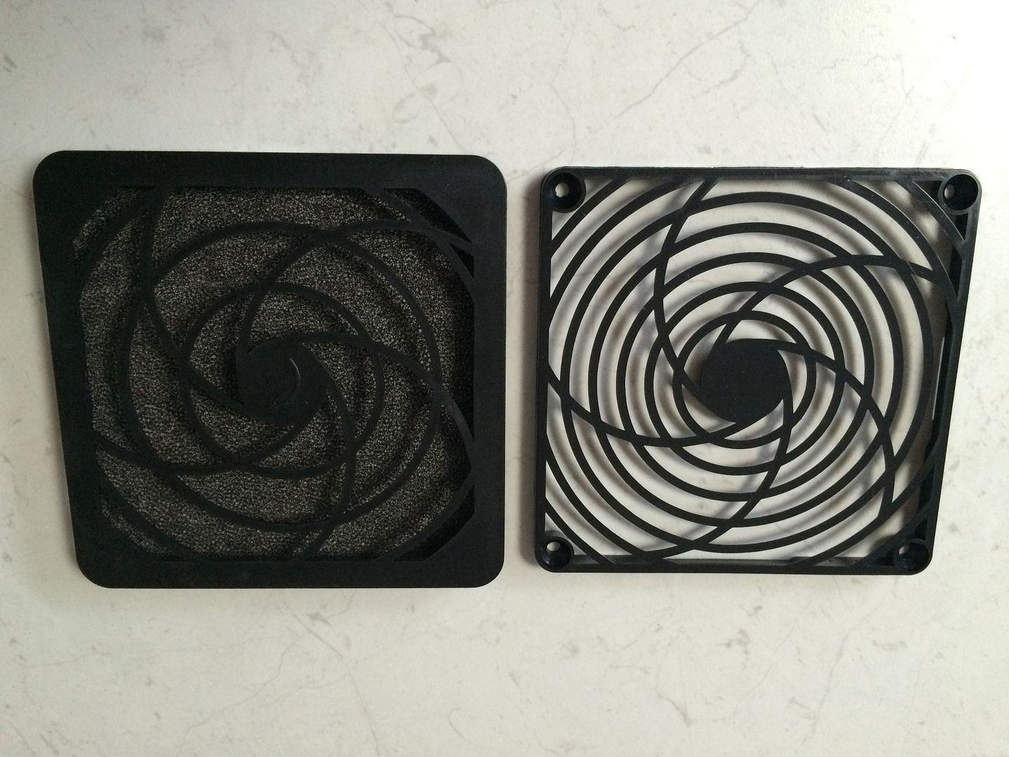

The monitor vent can go on too, this is one I bought from a KLOVer from a scrapped Championship Sprint cabinet as the one on this cabinet had been wrecked by the freight company trying to stow the mains lead by jamming the plug into the vent...
...I found a supplier of very similar screws to the Atari ones as I never had the full set and didn't really want the vent to be only held on by 3 mismatched head types originals instead of a matching set of six.
Ideally these should have been hex or square driver screws but that would be a pain to source without getting them from the US and buying through a freight forwarder, which for 6 screws would be pretty insane, even for this project.

As great as the coin door looks it is still missing everything that goes behind it, the mech frame, the mechs themselves and the  coin reject buttons that really make an Atari coin door look so great.
Time to reunite some more parts that have been rattling around loose for the last 4 years gathering dust. A quick strip, clean and oil later...
Love that the coin and country designation stickers are still on the US made mechs.
I toyed with the idea of putting the original coin cards back in the eject buttons but they were a very tatty and didn't even match style-wise. Thankfully someone had made up a sheet of "freeplay" coin cards for a range of coin doors with the relevant manufacturer logos that you just print out and cut up.
Which after the mechanism was finally reunited with the coin door (plus a spare key hook pinched from Paperboy which doesn't need it)...
... looks absolutely awesome!

Time to rebuild the control panel!!!
First up - the player 1 and 2 start buttons. The machine would was born with black leaf spring switches according to the manual diagram, and I had tracked down a couple from the US
Except nothing is ever quite that simple, the white base is a standard part, as is the leaf switch, but the button comes in two types, long and short. If you have a wooden CP, as was pretty common in the leaf spring era, you need the long button to get through the depth of the wooden panel and still have enough throw to operate the switch. Atari was a big fan of metal CPs so you need a short switch, but as Atari was so obsessed with black buttons and as their cabs are regularly restored to original spec there is now apparently a worldwide shortage of short black leaf spring style black switches - I guess no one is making them anymore.
If you use the long body switch and tighten everything as it would be with a metal CP you have a switch that its very very firmly on at all times.
The standard solution seems to be to put a standoff ring under the white switch body, but a simpler solution seemed to mount the switch further away from the panel at a distance where the springs. Even simpler is that a wrecked Midway leaf spring switch contains insulating shims that are a perfect fit for this.
This one came out the Pacman cabinet at Game Masters at ACMI, so if you went to that and were disappointed that the Pacman cab's joystick was knackered then something positive at least came out of it. That one switch got me six thick shims and one thin one, and the perfect standoff distance mod with this CP needed 3 thick and one thin shim.
Actually the screw that holds the leaf spring switch to the base is so overly long that it still has a tonne of thread left even at that standoff, which makes me think that this is the way you are suppose to do it.
The other switch took the remaining 3 thick shims and I made two ultra thin ones by cutting down the metal of the contacts to make up the missing shim.

With nothing left to do inside, the six security bolts went on, with slightly over sized black oxide washers as the CP had been held in with big bolts before and the bigger washers covered the past scars better...
...except for the two on the upper face of the CP.
