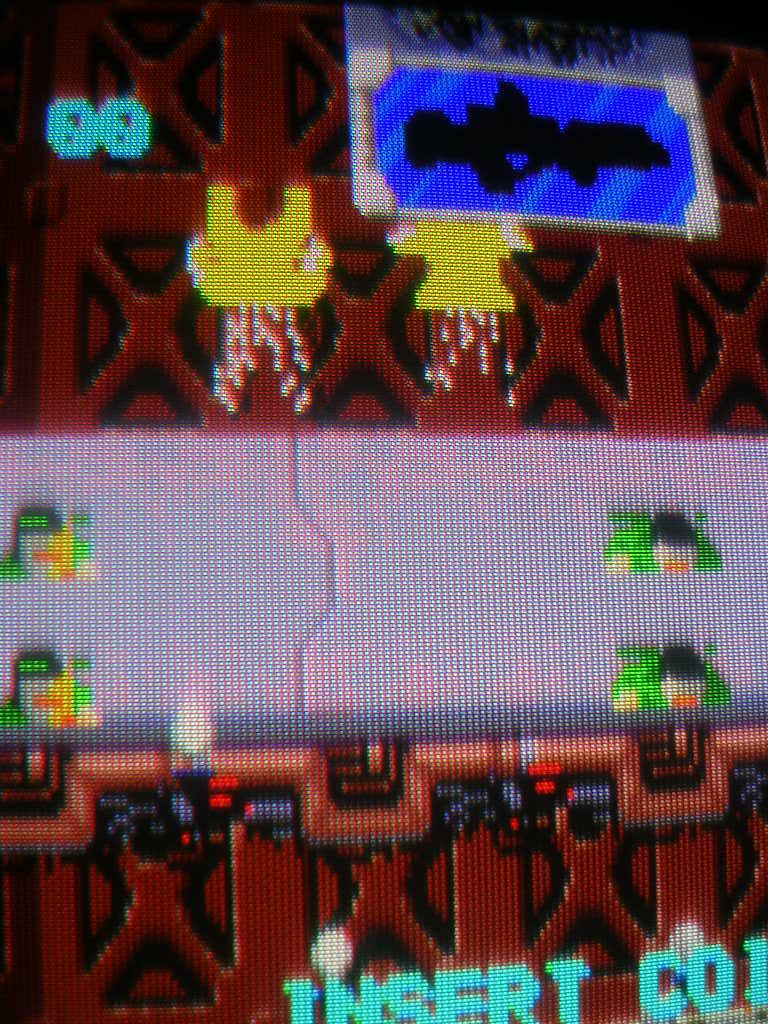

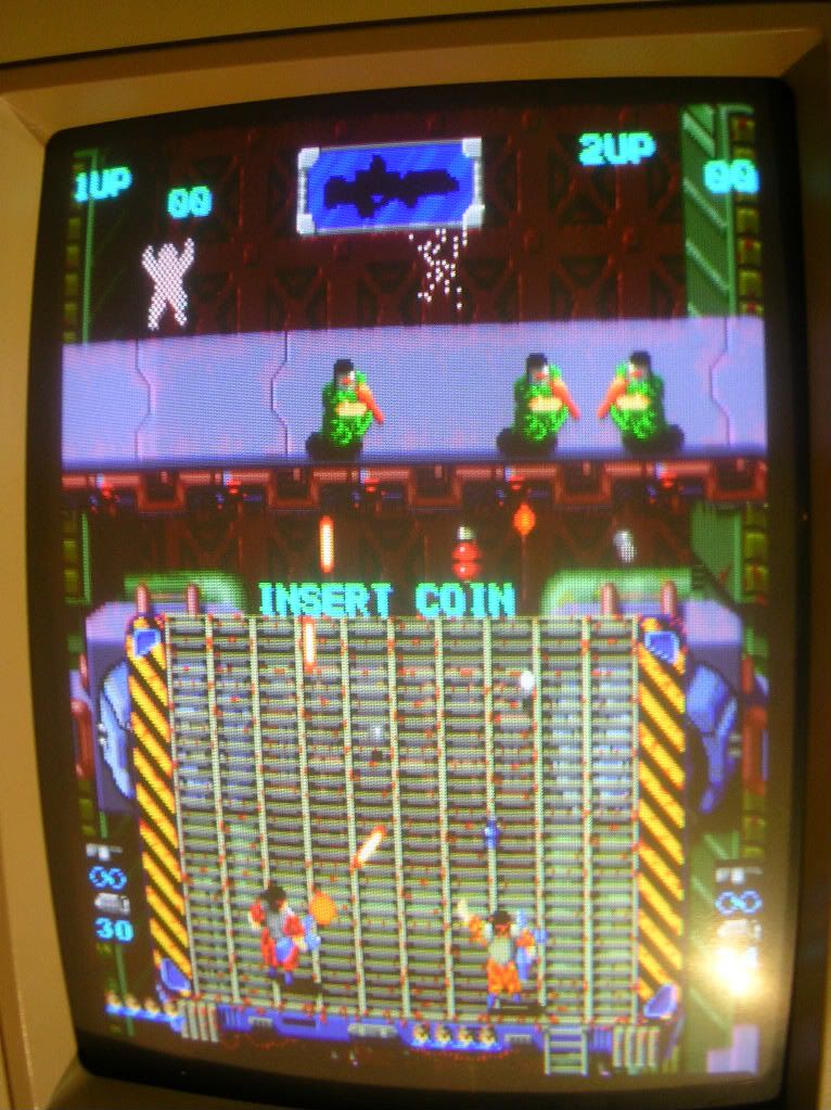

The fault was actually that the sprites were a mess, mostly unrecognisable, often doubled up fragments of sprites.
The collection of junk on the metal platform is supposed to be P1 and P2 character sprites.
The green blobs are the enemy sprites.!
Not exactly easy to see what is going on!
The enemies were mostly collections of green shoulders and heads, Player 1 is the collection of crap in the top left hand corner.

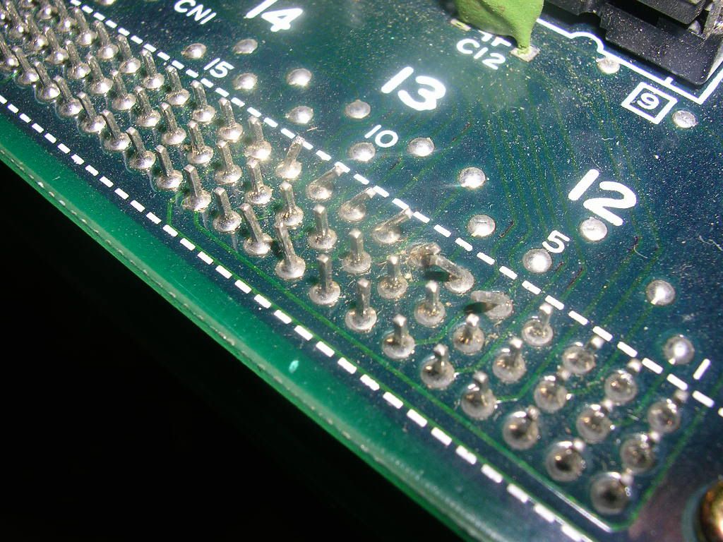

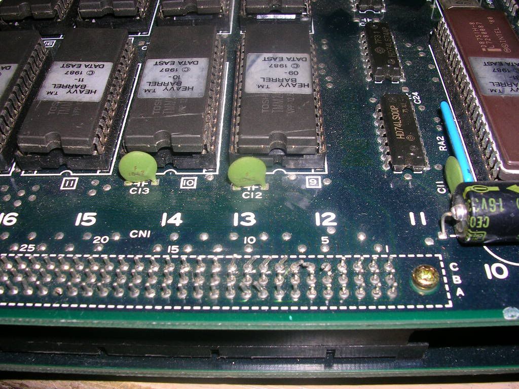

Clearly the vast majority of the board is in perfect working order as the game code runs, the display is solid, the colours are right, everything moves around as it should and the sound works. The only thing was the sprite blocks were wrong. Having narrowed it down like that it still leaves a tonne of options for the underlying fault. It could be bad ROMs, could be bad RAM, could be bad logic, it could even be bad custom chips, or it could be that someone at some stage knocked the board and bent two pins on the board interconnect together.
They had actually bent a few but only 2 were making cross contact, I confirmed this before I straightened them out and they did buzz as connected. Often when you find something like this they do turn out to be not quite making contact. This pair however were bent together with some force and were making good contact.
So I used a jewellers screwdriver to pry them apart and some pliers to restore all the pins to their original non-bent positions; powered up and the fault was gone...

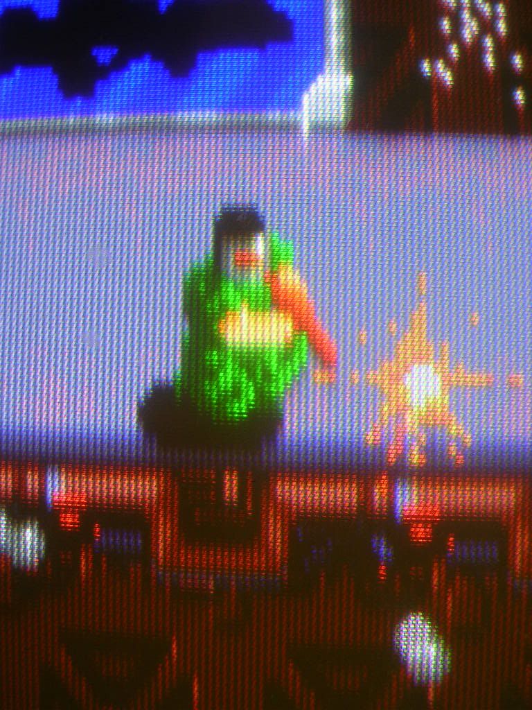

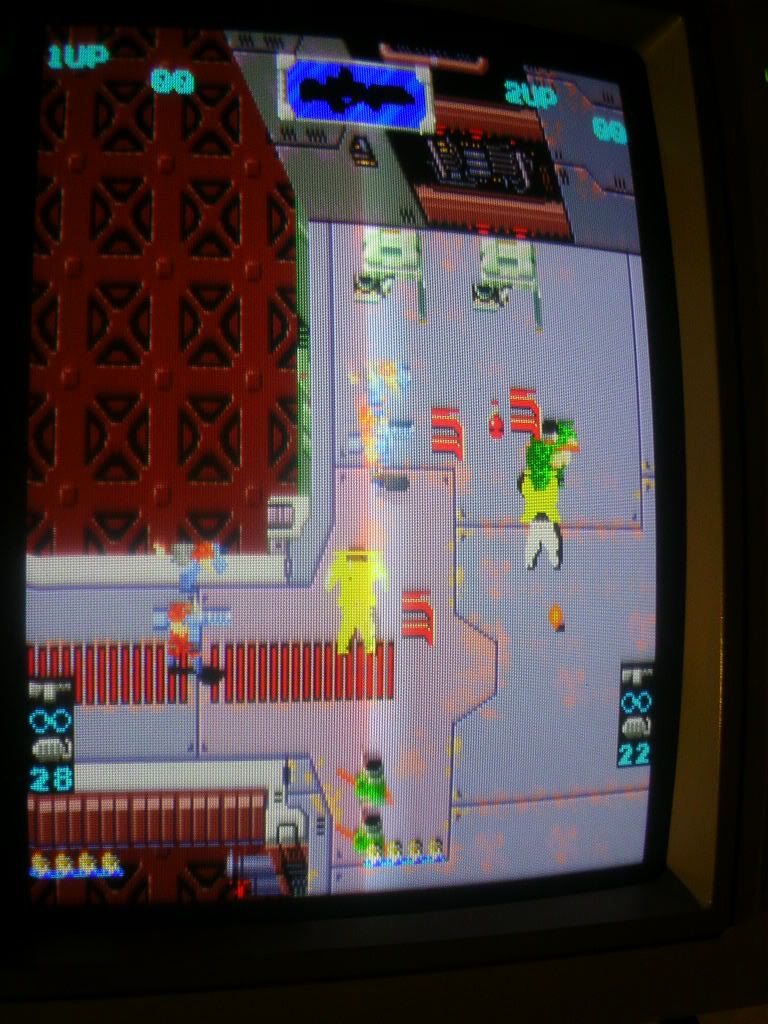

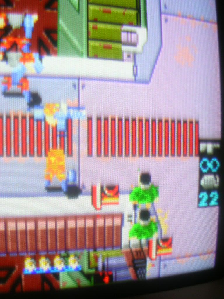

...P1 and P2 back to their original glory.
The enemy heads and shoulders now had arms, legs and weapons
And in general you can now see what the hell is supposed to be going on!
