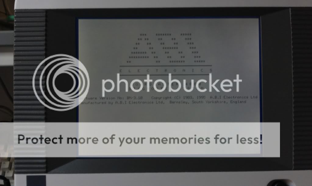

The BM4000 is a diagnostic tool for fault finding on PCBs. It has a built in LCD screen, floppy disk drive and has printer and RS232 outputs.
There is also a keyboard too which is used to program the unit, more on that later.

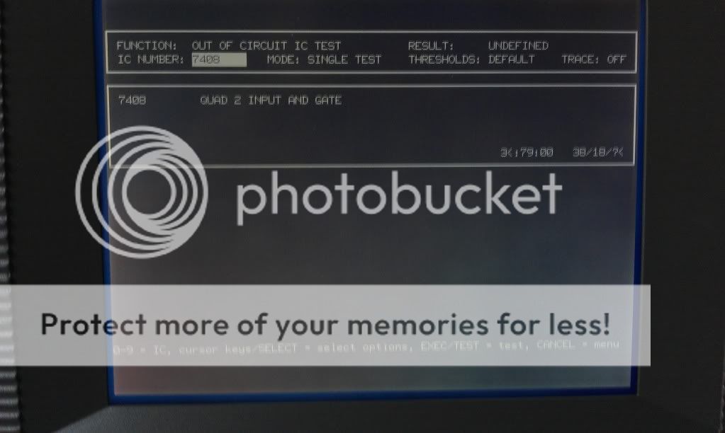

It is capable of testing a shed load of logic, RAM and processor ICs both in circuit and out of circuit.

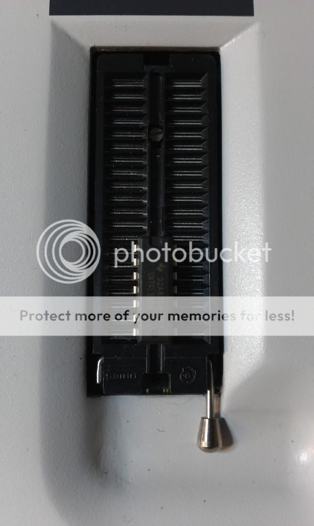

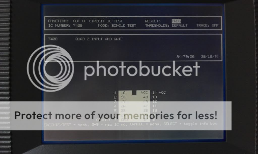

Testing out of circuit is really simple. Just a case of inserting the suspect IC into the ZIF socket on the unit, keying in the ID number and hitting EXECUTE.
The In-circuit testing feature is a little more involved but not difficult.

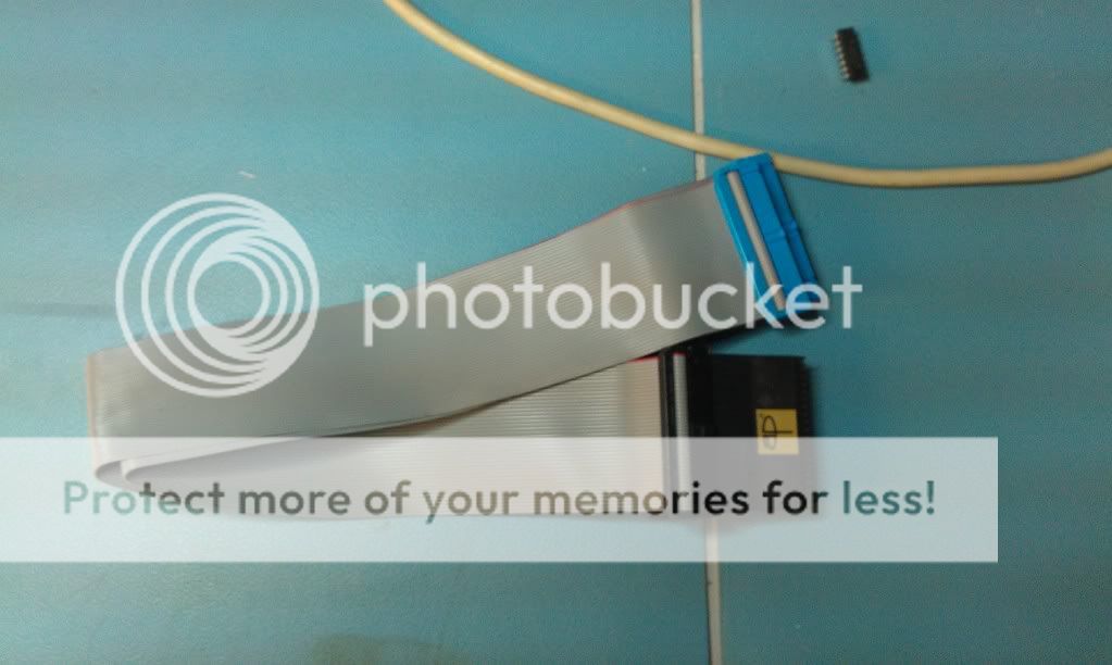

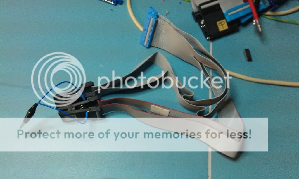

There are a couple of test clips provided, a couple of 20pin ones
and a 40pin one, useful for testing Z80 CPU in circuit.
Also provided is the BDO (Bus Disable Output) lead which has several pin clips on which can be configured to logic HIGH or LOW and are used for disabling clocks etc. There is also a couple of test probes on this that are used for locating short circuits.

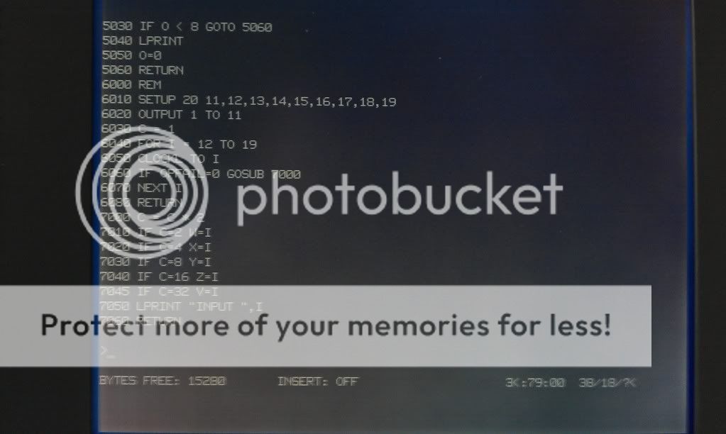

A great feature of the Boardmaster is the programming language which is called TestBasic. It is a stripped down version of the BASIC language with a couple of added commands to accomodate testing and feedback.
This is a very useful feature and can be used to accomodate all sorts of different ICs.
The built in floppy drive is used to save programs and to save board test results if the option is selected.
