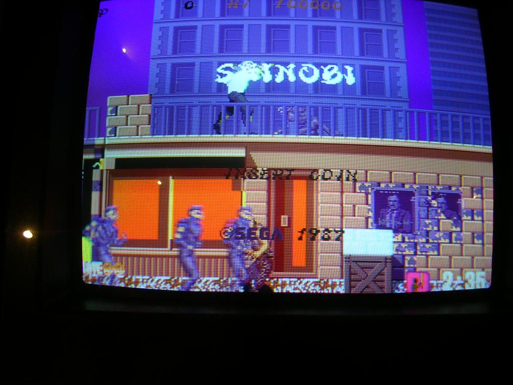

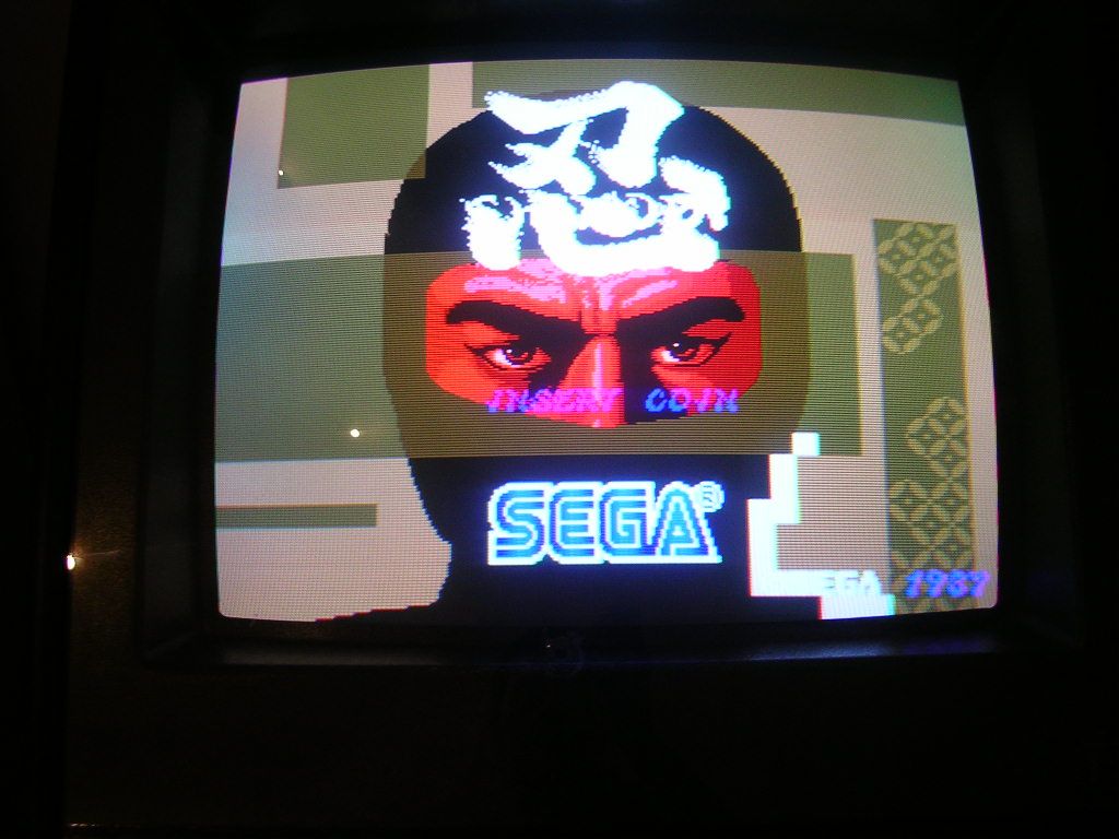

At some point way back in 2011 I picked up a dead Shinobi board on eBay, according to my notes the seller said it had worked until recently, but then developed graphics issues. However when hooked up to my test bench via a System 16 - JAMMA harness it was completely dead, no video, no sound, no life. A quick scoot around with the scope showed that the lower board was completely powered off. Despite the 3 50 way ribbon cable interconnects between the boards the power supply to this lower board is via an external connector which through a combination of broken connector latches and badly re-soldered joints on both boards was no longer connecting the two PCBs
Someone had re-soldered this at some point but hadn't pressed the connector back hard up against the board and made a hash of the soldering, so the bad joints just broke again leaving the connector loose. A complete desolder and a proper re-solder on both boards fixed the issue. Even with the broken latches it can be fully engaged, its just a bit more of a faff.

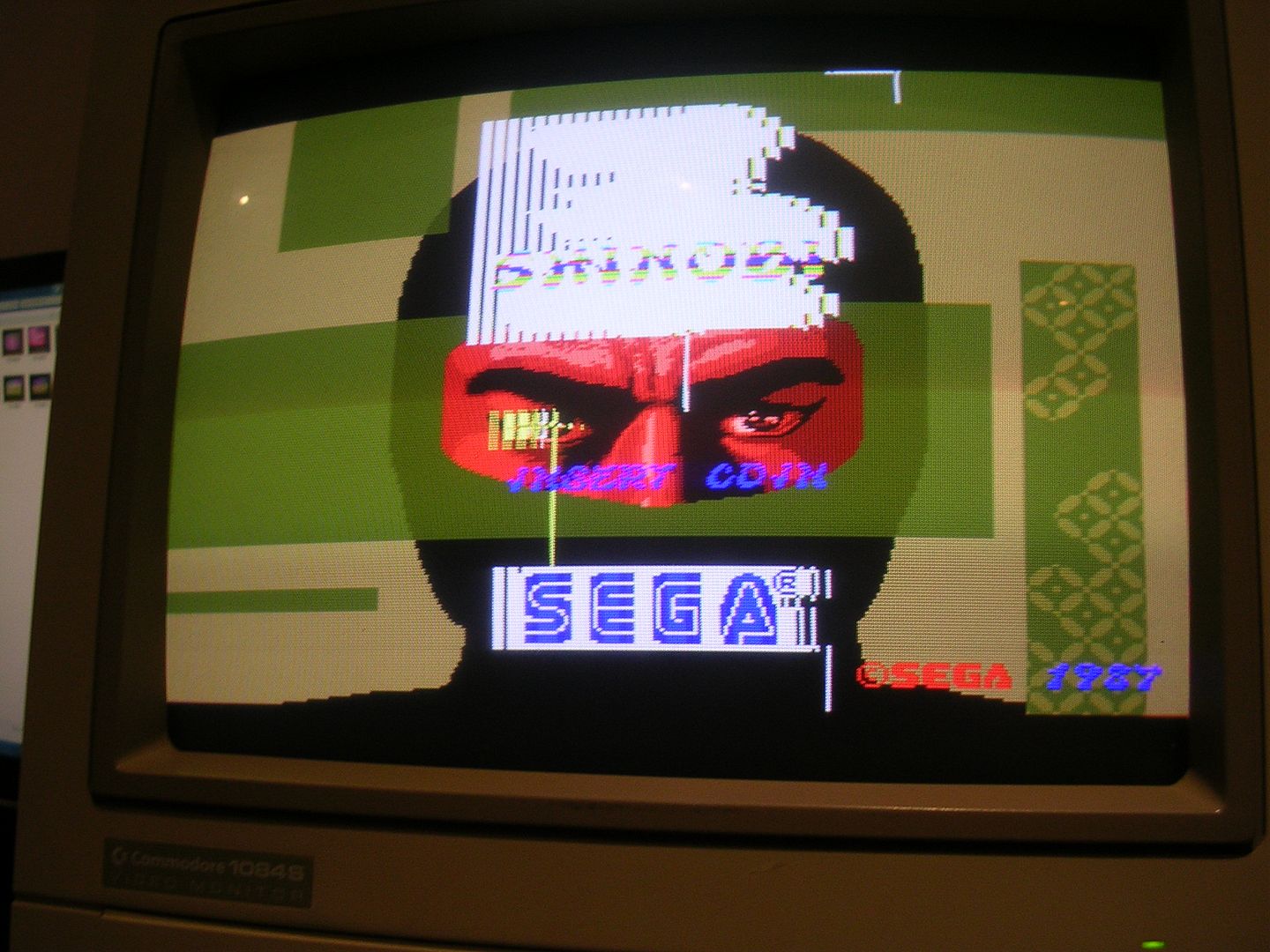

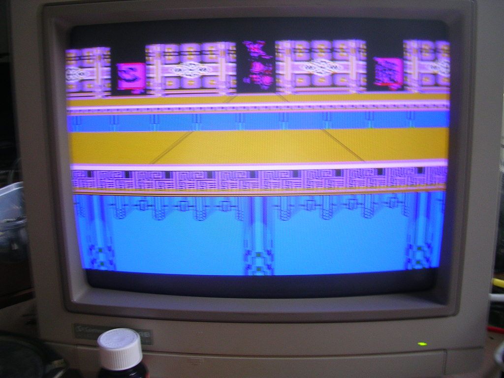

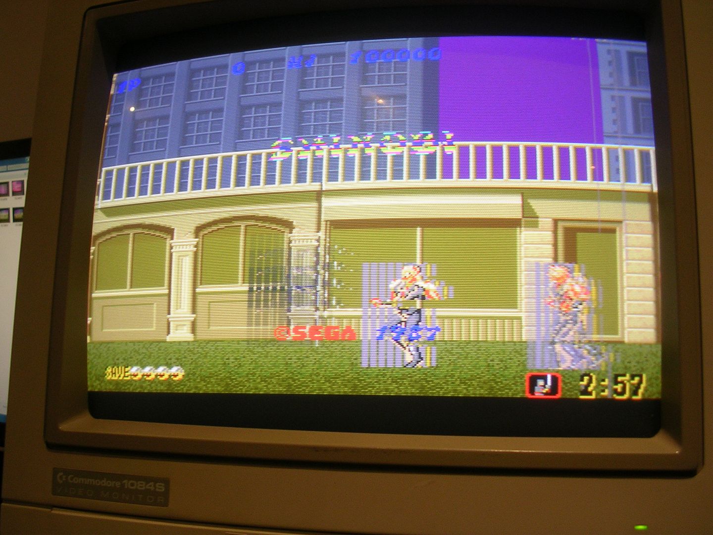

The old faults as described by the seller were back, slight corruption on the title screen giving a blocky pattern around the ninja's neck...

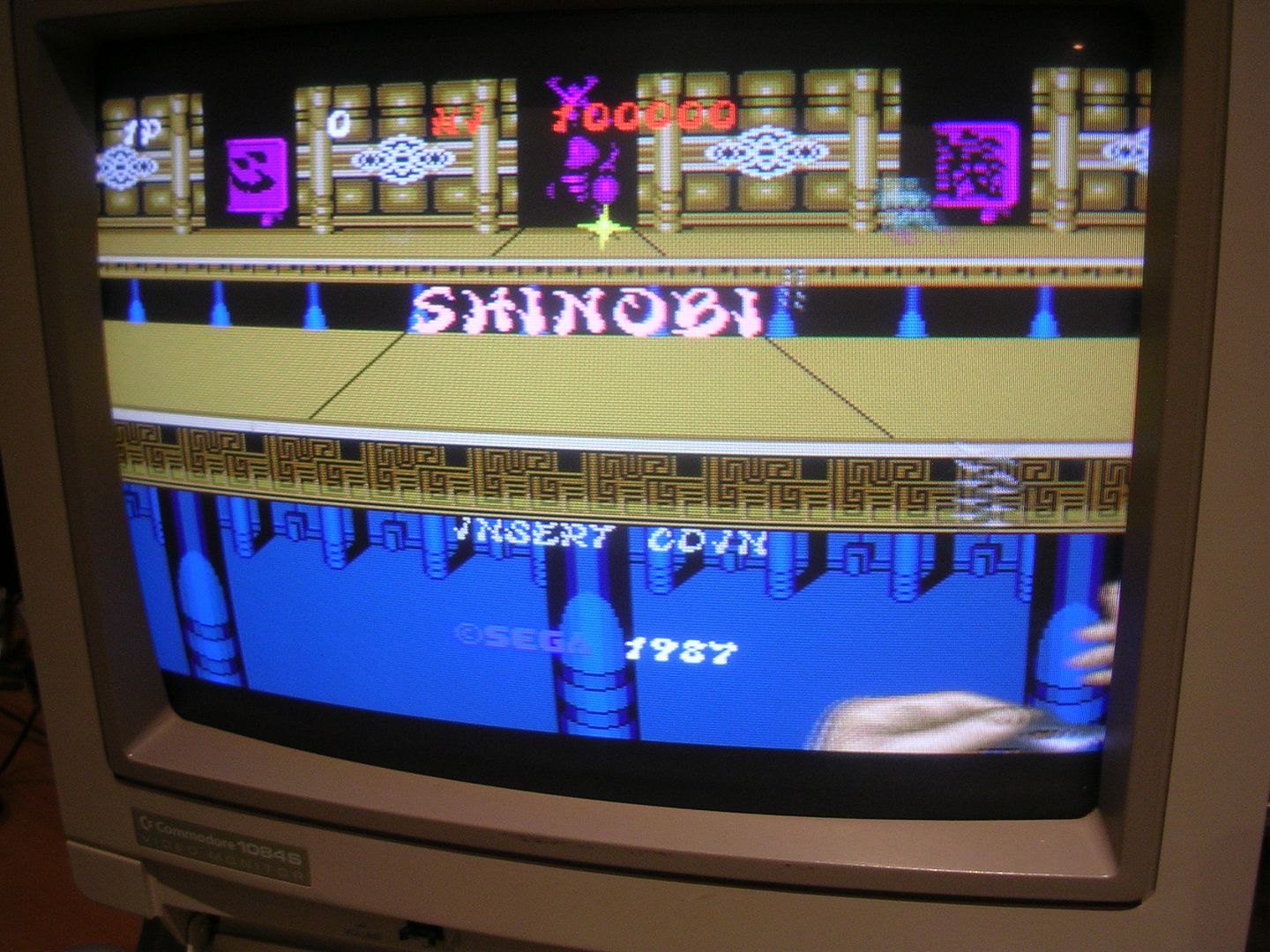

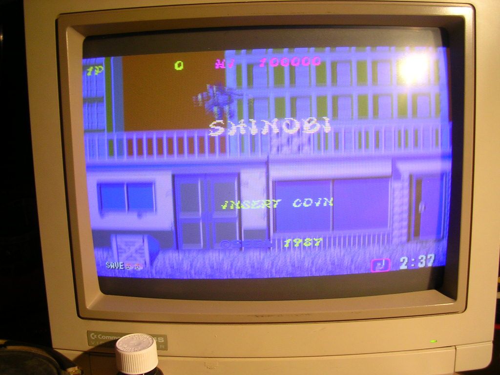

... corruption on the building frontages, a Fisher Price colour scheme, plus a nice snow effect on the ground...
...and the bonus stage was almost completely red - nice!
Also when the main character was on the upper level of the 1st stage and jumped, all the foregrounds vanished until he landed again. Basically the background was drawn infront of the foreground and some of the sprites.

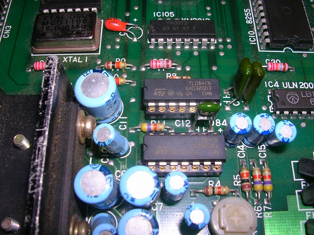

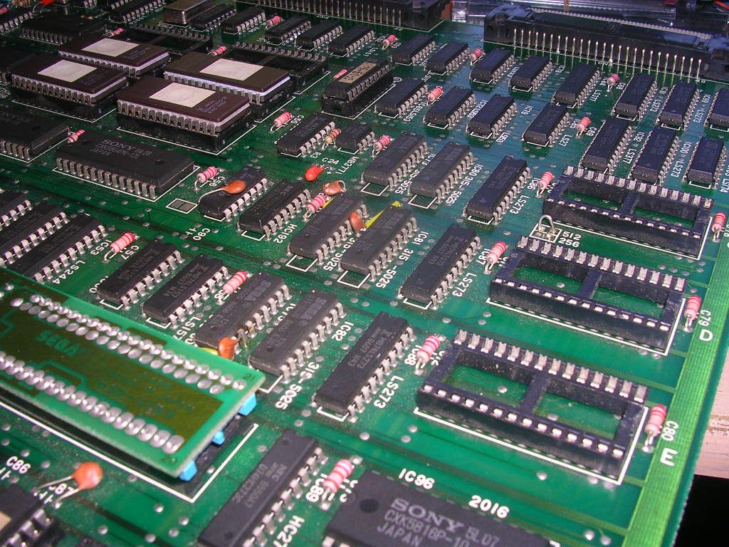

First thing to fix was the obvious damage, a number of decoupling caps had taken a beating and had legs wrenched out...
... or were completely missing, torn off the board.
Replacing those had no effect but they are there to increase the power stability of the board and if too many are missing or damaged it can make the board glitchy.

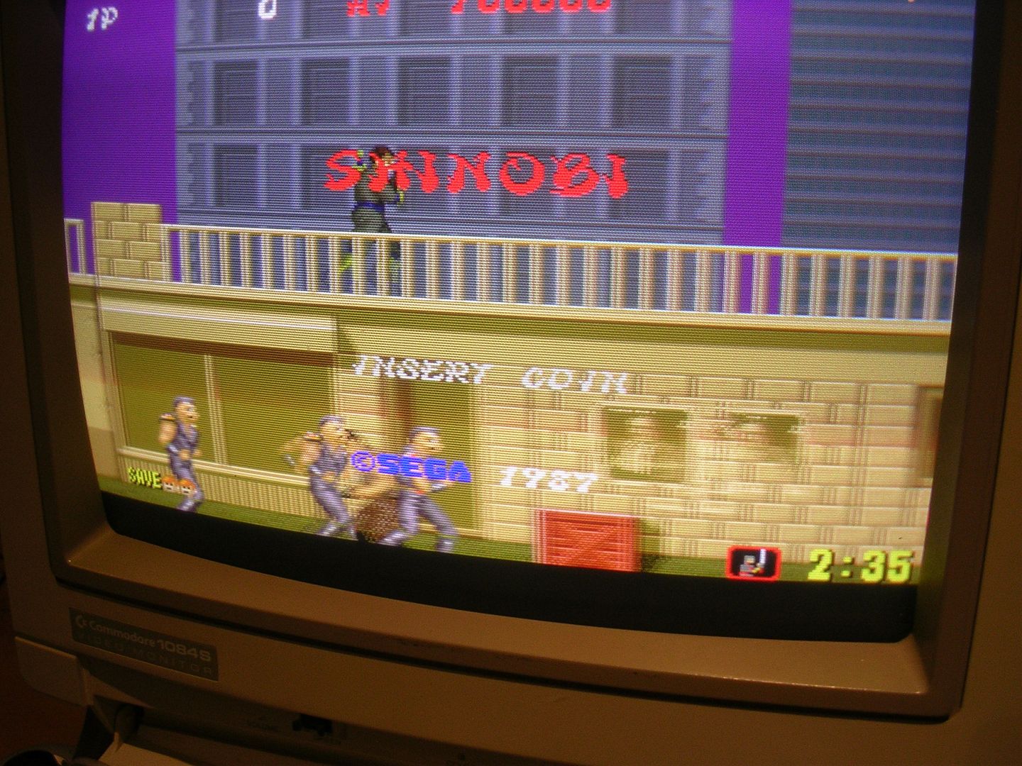

The board was pretty heavily populated with Fujitsu TTLs, and a load of 74LS157s which always seem to be the flakiest ones, so I went round them all with the logic probe looking for floating outputs. All of the above faults above, with the exception of the jumping background fault were caused by a single bad 74LS157 at IC40 which was sporting a number of missing outputs. It got desoldered...
... and replaced, which fixed up the graphics nicely.

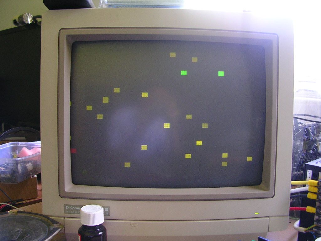

So I hooked my probably 99% OK video board to the other CPU board and fired it up. I got a black screen and the constant clicking in the speaker which is the watchdog system trying endlessly to get the board to boot. This was exactly what it was doing 2 years ago when Jump1Left sent it to me. The repair log I started was just a text file full of locations of suspect chips and notes that large sections of the CPU board were stone dead, along with a long list of damage to the video board. This board set had clearly seen some real violence it its past, probably someone plugging it in to a JAMMA harness and leaving it to fry.
When I originally received it the board had a standard 68000 CPU on it, but the ROMs were the original ones containing the encrypted code for the missing FD109 encrypted CPU block. I had burnt the unencrypted set for the board when it arrived so that was no longer an issue. I went back over the CPU board with the logic comparator and had tested all the Fujitsu TTLs present, only finding one bad 74ls30 at IC56 and a dodgy looking 74ls244 at IC33 using the scope. The problem was still that so much of the board was shut down that a large number of chips had no active input signals, so the chance of false negatives was high.
Now I at least knew the fault was somewhere on this CPU board so I pretty much started from the beginning.

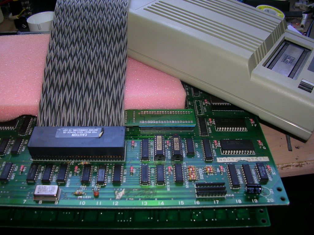

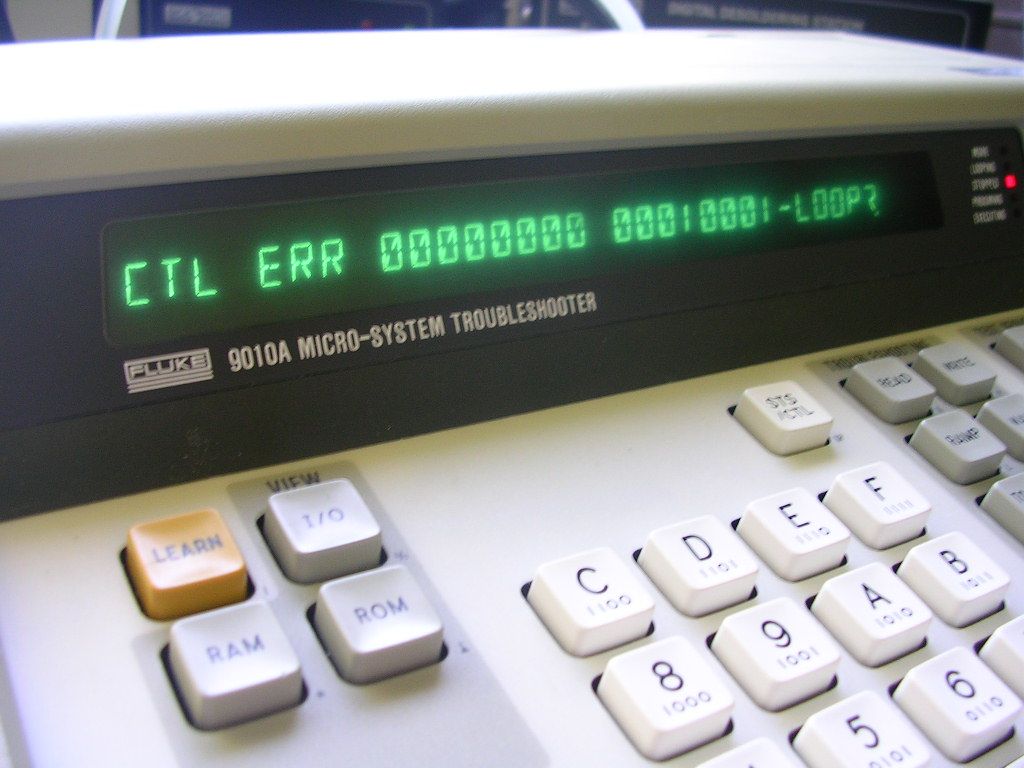

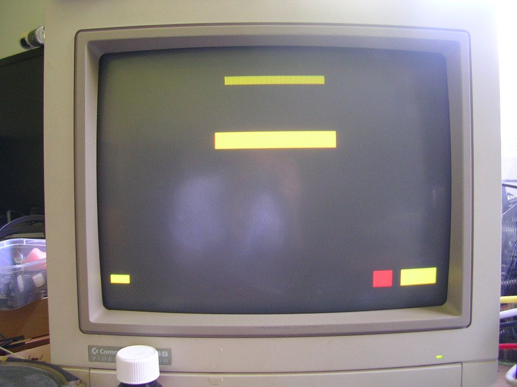

Faced with an uphill battle I decided to wheel out the big gun, the Fluke 9010 and the 68000 Pod.
The Bus Test function gave me the following fault...
...which translates to the fact that the /HALT line and the /RESET line were causing problems. Poking round these areas of the board with the scope gave no clues so I told it to ignore all the errors and carry on. To my surprise it booted!

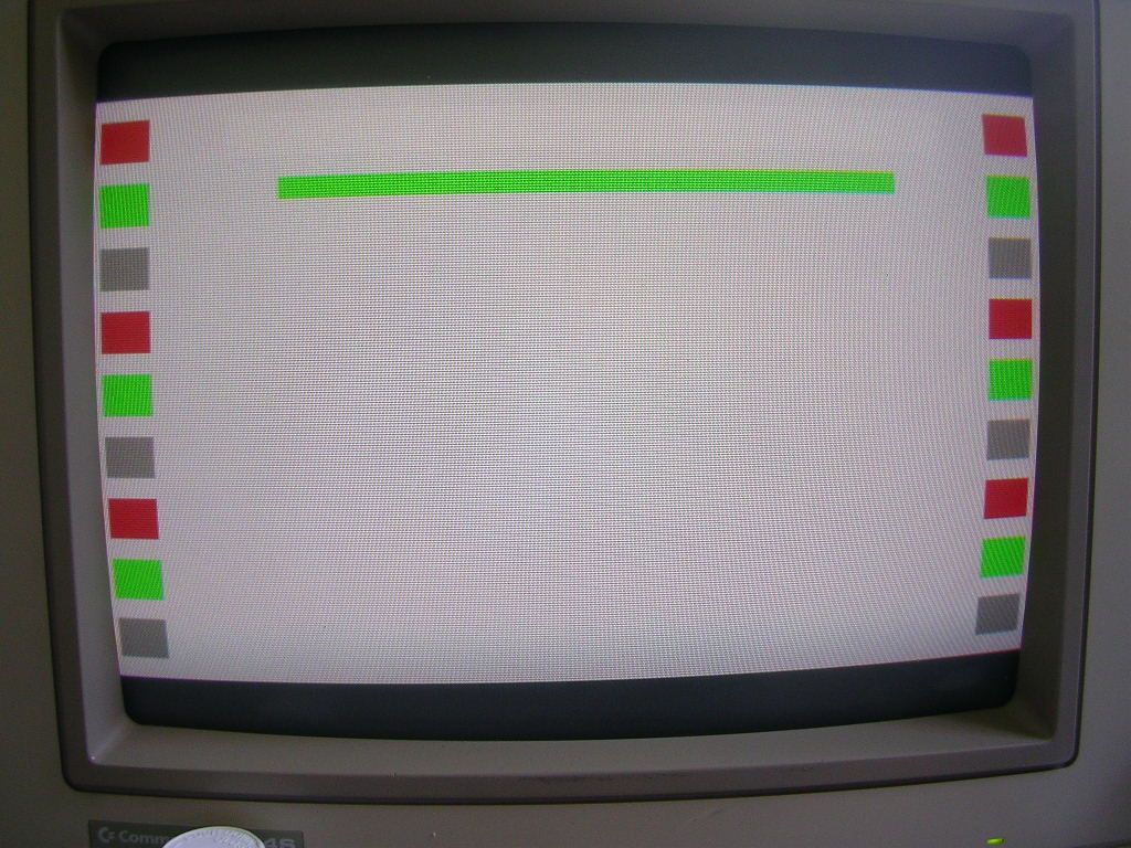

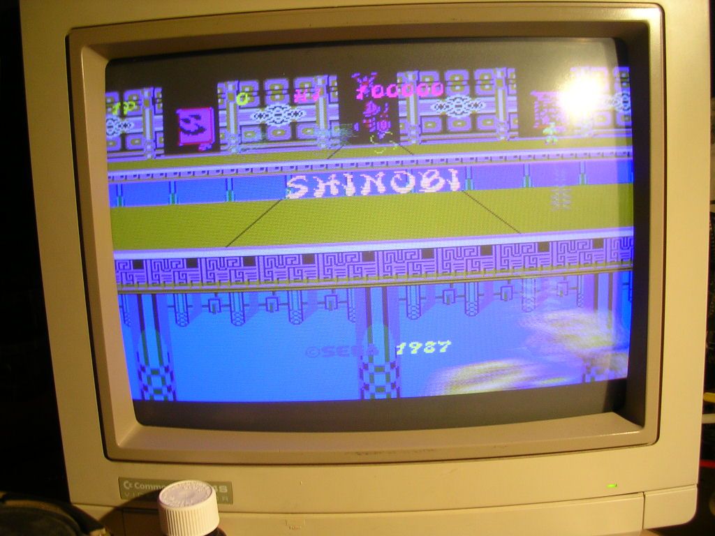

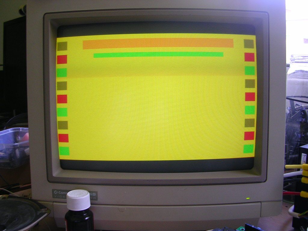

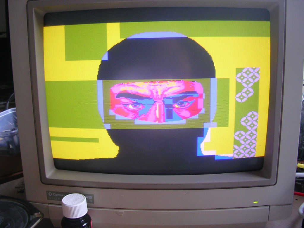

It doesn't look like much but the large yellow bar was flashing, and after a few seconds it changed to this...
...which looks worse, and then this...
... and then it repeated, this is actually the attract mode running. The flashing bar is the flashing "Insert Coin" area of the screen and the final image above is actually the wreckage of the high score table.
It is missing most of the actual data it is supposed to be displaying and the colours are missing blue but it was successfully running the program code.
When I disconnected the Fluke and put the old 68000 CPU back on the board it continued to do the same, happily running attract mode, very odd. Until the next day when it was back to the black screen and constant watchdog resetting. The culprit for all of this was the CPU socket. It's a machined pin socket so it should be bullet proof, but whether through dirt or oxidisation the CPU was not making good contact on all its pins. So I cleaned the CPU pins, bent them outwards slightly and reseated the CPU a final time to chase the fault away. The missing blue seems to come and go and wasn't a bad connection on the edge connector.

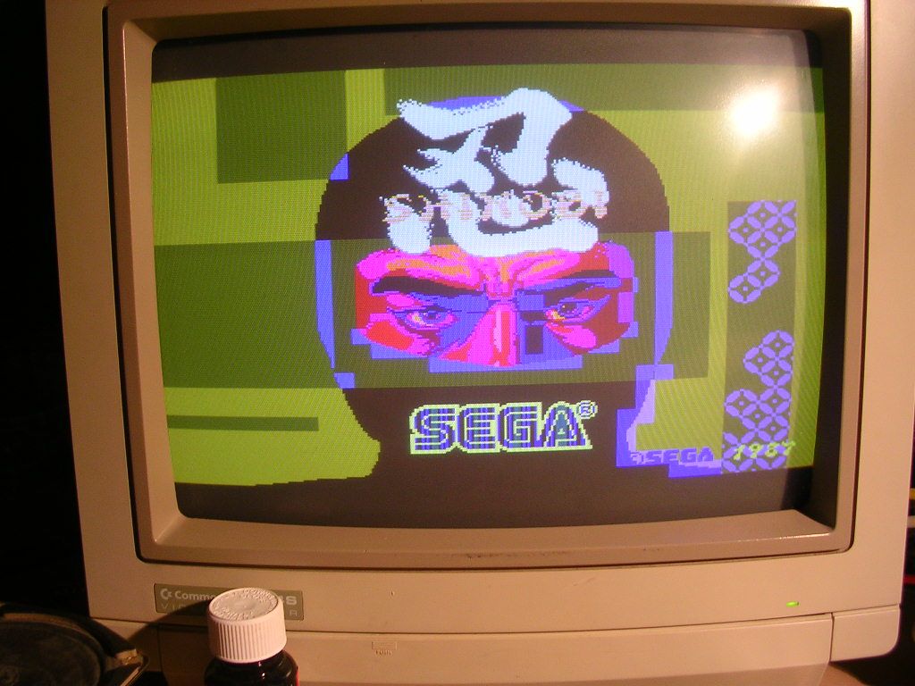

... the output pins on IC96 were a mess on the scope, almost like a city skyline, a classic sign of bus contention when more than one chip is talking on the bus at once and the signals are fighting each other. This chip did pass the off board tests in the EPROM reader but clearly it cannot operate on a shared bus as when I put a known good SRAM chip in its place I got this...
...background data, the board was slowly waking up.

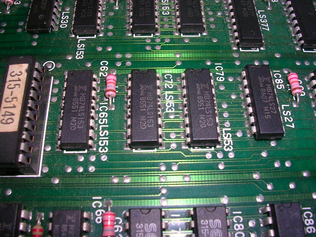

Further poking around revealed that the collection of LS153s...
...nearby had a fair number of floating input pins. The silent inputs all traced back to a 74LS174 at IC102, pins 10, 12 and 15 outputs were all floating....
...oddly enough, so were the inputs to those gates, which went to outputs on a second 74LS174 at IC103.
These outputs were fed by inputs that again were floating, which were fed by outputs of other gates on the same chip, again floating outputs. After hoping through 3 gates I got back to the first input to the 174s and found a healthy signal. Both 74LS174s were completely shot, and had died in the Fujitsu way, despite being SGS brand. Which explained why I hadn't found them with the logic comparator beforehand as I usually only bother the brute force method with Fujitsu chips due to the way they tend to fail.

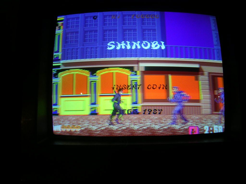

Once these two were replaced...
... I had foreground text and sprites...
...even if the colours were still pretty unwell.
At this stage I knew I wasn't missing a colour channel on the output as I had white sections of graphics and to get white you need Red, Green and Blue channels to be working. So I focused on what I was assuming was the final stage of the video assembly in the bottom right corner of the CPU board.

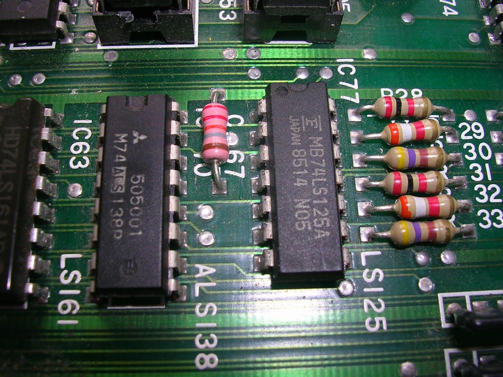

I poked the scope at the Fujitsu 74LS125 at IC77
and its outputs looked fairly mangled so I dug up a spare on a scrap board to test the one at IC77 and it came back as having timing issues so the spare got soldered onto the board.
Nothing improved so I moved on, the original one may not have been an issue anyway but its a Fujitsu so I am never too bothered about retiring one prematurely.

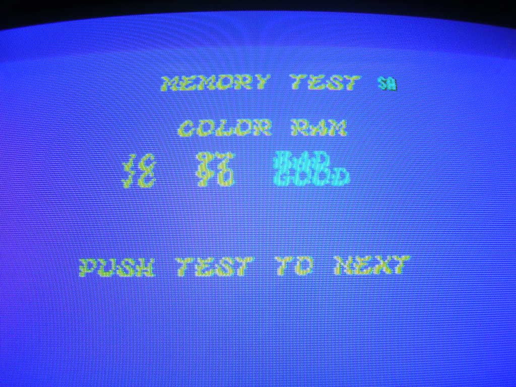

At this stage I decided to put the board into test mode to see what it could tell me now I had video output and working text. The problem was that the service mode button did not work, the game would also not coin up so I couldn't even start a game for a play test. This was all down to the four Fujitsu 74LS253s lined up along the width of the the board by the edge connector, ICs 5,6,7 and 8. Replacing those brought back the ability for the board to register buttons and switch inputs.
Once into test mode I stepped through the tests and got the following report...
... which is a bit bizarre as IC90 is not a RAM chip at all, its a 74HC273. The SRAM chips are IC96 and 97 so unless that is a rather stylised "6" it is a typo in the main code. Either way, IC97 is a SRAM chip and it was reported as bad. This is the remaining chip from the pair that I replaced one of earlier, so I removed it and dropped it a known good one - no change. Its outputs looked fine on the scope but I noticed I could short out the data bus pins on that chip and have no effect at all on the screen. The address bus is shared so any shorts there caused the screen to go nuts. Clearly the data was leaving the chip, and presumably arriving too, so the egress path from this area to the downstream colour processing was not working correctly. As is fairly common on data buses there was a paired HC273 IC90 and an LS245 at IC98.
The 273 was an NEC chip while the 245 was a Fujitsu, guess which was the prime suspect?
The Fuj!
I actually replaced both IC98 and IC101 as they are a matched pair and often seem to be damaged as a pair too. The result was this...

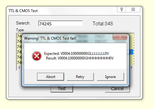

Two passed the off-board tests, but the overheating pair failed, all got binned and replaced with salvaged ones.

This would leave the screen a screaming mess most of the time, sometimes it would lock for a second or two, sometimes ten seconds but it was never what I would call stable. The sync signal leaving the board actually looked fairly healthy from a signal perspective, it was clearly mostly nonsense as far as the monitor was concerned. The actual output comes from pin 6 on 74LS86 at IC57, which takes Horizontal Sync on pin 4 and Vertical sync on pin 5 to create the composite sync output marked in red below.
I had pulses on pin 4 of the LS86 but not pin 5, which was mostly silent with the odd twitch. The twitch seemed to correspond with the moments that the screen sync would jump. It used to sync from time to time but had been getting progressively worse until the point where it hardly ever managed to sync. As the 74LS86 was a Fujitsu I just replaced it, which didn't give any improvement.
The initial concern was that the whole area involved a nest of 3 PAL chips closely interconnected, but as I had already swapped the PAL chips over to rule out issues on the other video board I knew they were fine. The only chance was one had just decided to die, so I swapped the sets back again and got no change in the fault.
The twitching Horizontal Sync tracked back to the output on the PAL at IC66 which takes its inputs from a stack of 74LS699 counter ICs, these were connected via the "carry output" pin so that the total count would overflow from one chip to the next in the stack, with the binary count outputs of all three fed into the PAL. Going over the 699s with the scope showed something smelly on IC60...
...the carry pin was not transitioning correctly, the pattern was there but the voltage never fell below 3.5 volts so would be a logic high at all times.
I guess on the odd occasion it did just dip below the low threshold which would explain why it sometimes did sync briefly. Once this chip was replaced the system could again count out the time intervals required between pulses and I had a rock solid image to work with again.

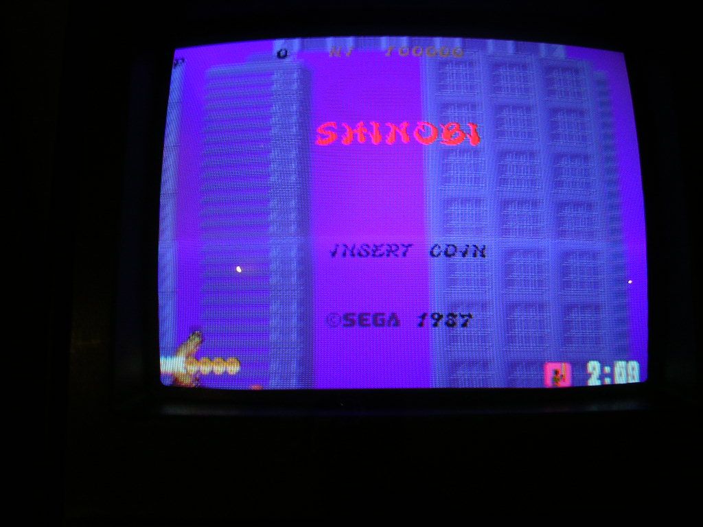

The image was now this...
...pretty messed up with none of the graphical elements correctly displayed. I was unsure whether this was due to a missing sprite plane, or another plane priority issue where the sprites were OK but behind the messed up background. So I started out at the Sprite 2148 SRAM chips and found of the data outputs on the four lefter-most chips were not transitioning healthily, they were mostly constrained low and so would never make it into the logic high threshold.
The options here were either the RAM chips were bad (but all four being bad seemed unlikely) or something on the bus was jamming their lines low. The opposite of something jamming them low, is a loss of their pull up, the lines on these 4 RAMs did not have external pull up resistors so they should in theory rely on pullup ability of something else on the bus. The outputs were striped across a pair of 74LS374 chips(IC63 and IC71), a single LS244 chip (IC55) and a trio of LS399 chips (IC77, IC81, IC89).
Of these only one, the LS244 was a Fujitsu , however this is not the mode by which Fujitsu TTLs tend to die. They appear to lose internal connectivity so their inputs should be unloaded not loaded down. Anyway the Fujitsu came off the board and tested as totally shagged.
The issue was this did not release the data lines as expected, even with the IC55 location unpopulated.
so I removed each LS374 in turn only to find they tested OK. A positive result on the tester is not as indicative as a negative result and I was still looking for the pull-up function that was probably the root cause of the squashed-low signals. The LS244 does not contain internal pull ups, but the LS374 chips do, so I was left with the situation that both the LS374s were actually bad when in a system requiring their internal pull up function. The LS399s on the bus were connected with their inputs so it wasn't very likely that both were bad, but I had two seemingly bad 374s in view, and 374s had been a failure on these boards before. So a salvaged 244 and a pair of 374s were installed and the data lines lit up again.
Sadly the onscreen result of this was zero, the outputs of the section I had restored was either being fed junk data at source, or its output was getting lost elsewhere.

Poking around with the scope I could see that sometimes D2 and D6 on both would just stop working or would hover around randomly.
The weird thing was that I could wake them up by shorting them to their neighbour pin and they would act normally for a while, then go quiet again. Following D2 onto the bus took me to pin 16 on the LS145 at IC108 and pin 7 on the LS374 at IC109. The 245 should be A-side input paired to its neighbour, picking up the pullup resistors along the way, mostly they all did and were busy...
...except D2 and D6, which were silent and had no continuity to their allocated pull up pin.
I had replaced the 245 at IC108 a long time ago during the bulk replace stage and I couldn't see any signs of track or pad damage, but clearly these two tracks had let go at some point, possibly as a result of the replacement, or at some stage in the distant past. Bridging the lines to the pullup pack remade the connection and fixed the background and foreground graphics in one hit.

Next step was the speech, the voice should say "Mission 1" and the noise kinda sounded like it was saying the right thing but extremely muffled yet in time with the syllables. My first thought was something to do with the Op-Amp at IC8, a uA3403 chip.
The capacitor next to it didn't look in great shape, it was showing signs it had been wrenched to one side and then straightened up again, which leaves one leg torn off inside. A quick check with the ESR meter showed this cap to have and ESR of 42 Ohms...
...which is hugely out of spec, it should be around 1 Ohm, so it got replaced, but the fault remained. The other candidates were the Op-Amp and the 74HC244 chip which was connected to the ladder DAC so its outputs were somewhat tortured anyway. The op-amp seemed the most likely so I removed it, fitted a socket and dropped in a known good one, which didn't fix the fault. The HC244 at IC7 is the last digital stage before the array of resistors forming the DAC and was the only candidate left.
It was removed...
...and it tested bad on my EPROM reader.
I didn't have any HC chips so I temporarily dropped in an LS244 and fired it up, speech fixed! Added the HC244 chip to my Jaycar shopping list and called the board preliminarily finished. Except not quite...
I set about bolting both board sets together using some sw***y machined metal standoffs, spring washers and bolts and put both boards through a quick play test on my cab. My fixed board set went first and after ten minutes of play I swapped to the one I had just fixed. The rainbow coloured Shinobi title hadn't struck me as odd while I was working on the board, but having two working board sets side by side it was clearly wrong. On the first board set the title text flashes between red and white, on the second it is static with coloured stripes. Which do look cool but it can be hard to see sometimes against the background.
Also the high score table colours now looked wrong having seen the correct display with the other board.
I very quickly found I could annoy the fault at the location of what I thought was my clever attempt to make an LS378 chip from an LS377. Sure one is the octal variant (8 gates) and one is the hex version (6 gates). They hadn't just removed the gates nearest the far end of the chip, they had taken the middles ones out. Which meant the pin-out for the last gates on my modified chip was reversed, I had the data inputs and outputs the wrong way round on the gates at the far end of the chip. As 74LS378s are next to impossible to find on scrap boards and I wanted to verify the fix I re-modified the mod, chopped more legs off, fitted it in a socket and looped hookup wire to reverse the required pins.
Yep it's ugly, yep it worked, yep it was temporary, I ordered some LS378s the same day.
When the new 74LS378 arrived and the Jaycar-sourced 74HC244 were installed on the board I finally had two complete 100% working Shinobi PCBs.
