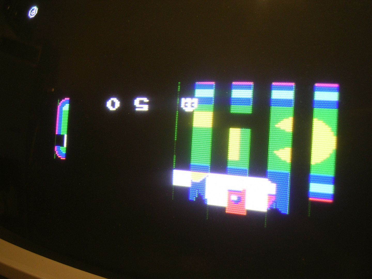

Piggy backing a working 08 did cause a change in the screen and got it looking much closer to what a working borad does during boot up self test, but as the output on the Ti 74LS08 chip was still driving the line, the piggy backer could not take full control, so the combined signal was not correct. That chip had to come off before I could make any progress.
It failed tests off board.
With that replaced things started to look a lot better, closer to what a successfully booting board does during the self tests.
