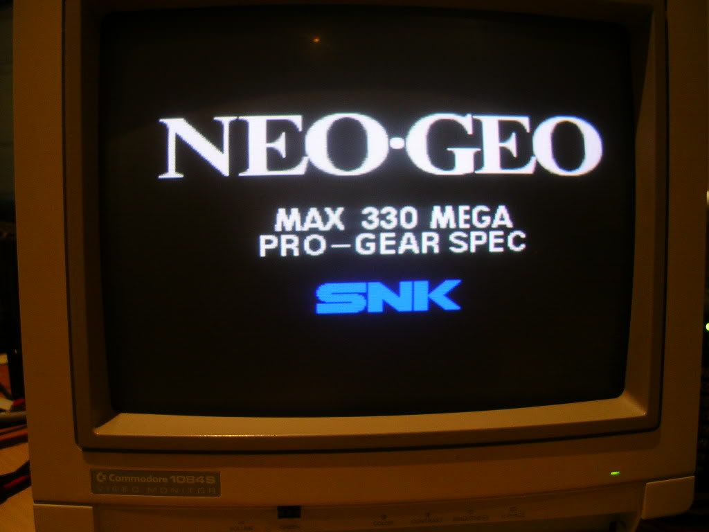

On power up again I got this...
... another error but at least it was now passing the Backup RAM tests. On subsequent reboots I either got this error message or it wedged on this screen..
... what is called "stuck on green". A healthy Neo Geo board will also display this green screen, but should then boot to a cross-hatch screen when it does not find a game cartridge. This never got past the green screen, which some reading around showed was basically another form of calendar error anyway. The most common cause of this is, on most Neo Geo boards, battery damage cutting the power to the NEC D4990 clock chip. This board had no battery damage and it the NEC chip had its 5V supply intact. The second most common failure is the 32.768MHz crystal, except on this board the crystal was happily wagging away. So again the the most likely cause was track rot. More googling threw up this superbly useful schematic (author unknown) of how the D4990 connects up on a 2 slot NG board...

... and on boot I got this!
A healthy cross-hatch screen, which is exactly what it should show when it has no game cart installed. All boot up tests were now passing!
So I put the cart support cradle back on, slapped in Metal Slug 2 and powered up and just got the cross hatch again.
Fault number 3, board does not notice game carts
